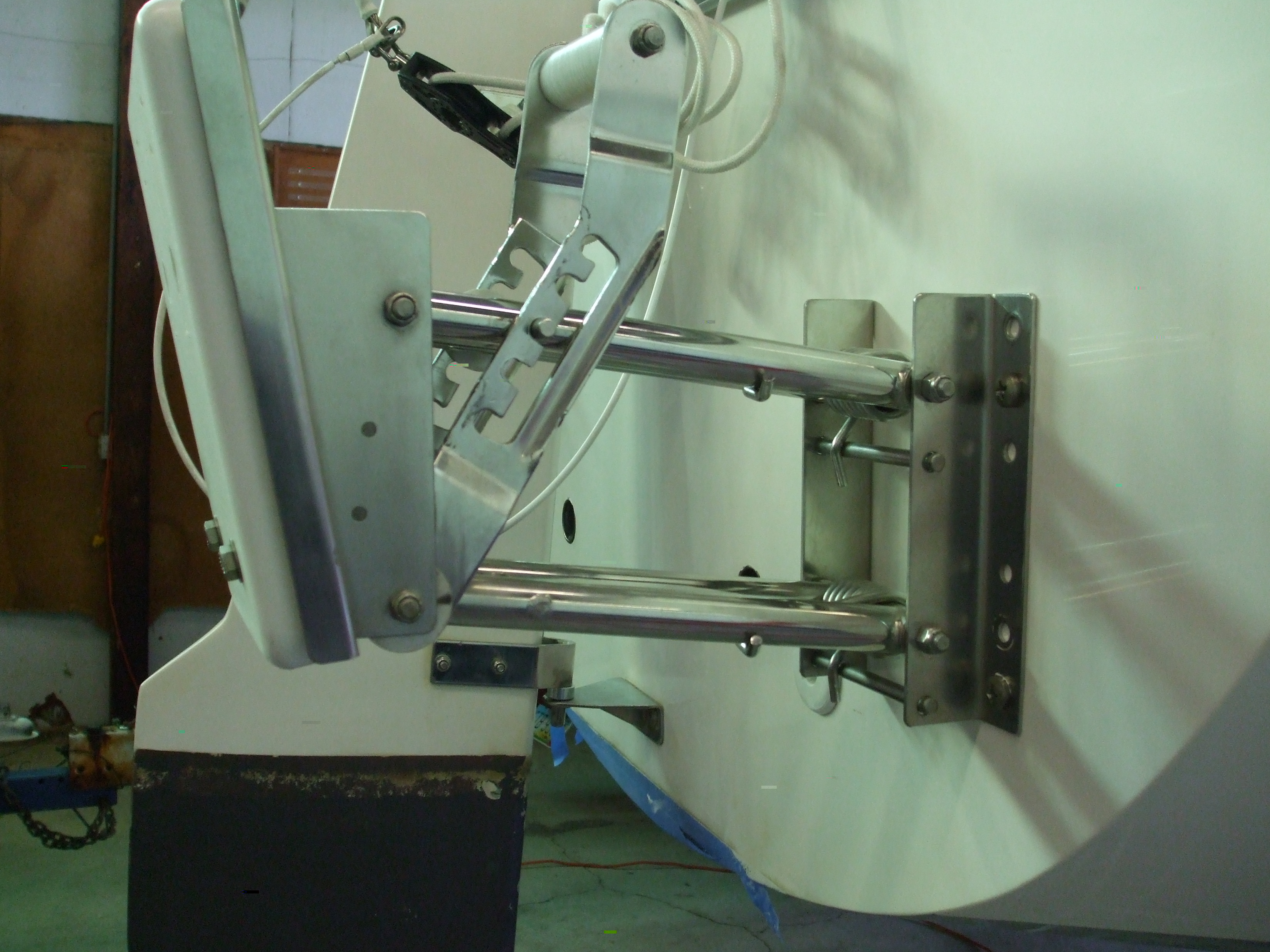

I've noticed that our new to us 2006 Capri 22's Motor Mount drags in the water when in the down position. We use a 5HP Honda with a long shaft. Unfortunately the mount can't be adjusted to stop this from happening. I believe I've read about this condition somewhere else on the forum before. There were only three positions on the Motor Mount Bracket's arm to select, two in the up position, one in the down position. This situation was further complicated by the fact that the bracket was bolted to the transom one hole lower than it had to be! To correct this situation, I removed the complete bracket from the boat to disassemble the mount so I could machine two addition adjusting notches in the bracket's arms to increase the adjustable range of the bracket. When I reinstalled the mount I move it into a higher hole next to the transom. This will, by itself provide 1 1/4 higher position. I believe the combination of these two modifications will provide the necessary improvement and cure the dragging Motor Mount Bracket. Note, the attached picture shows the 5 notches now available to adjust the mount and the new bolt hole location.
