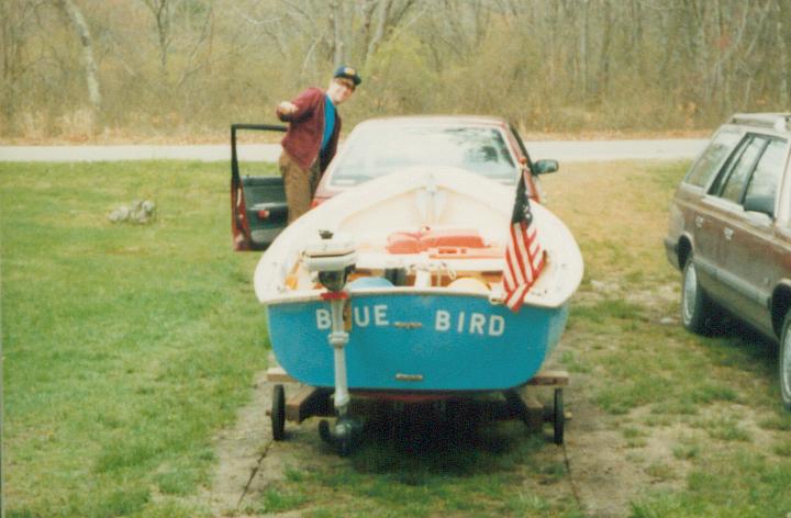

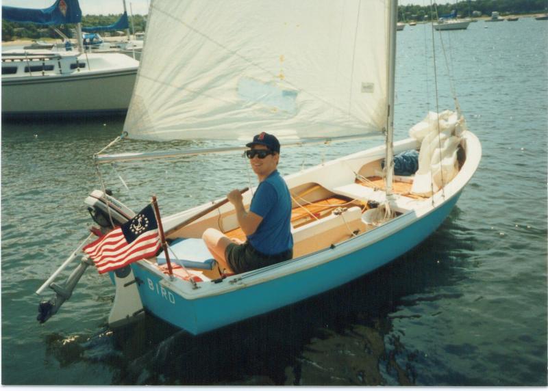

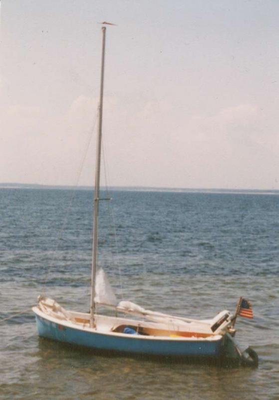

I used a 1984 JOHNSON 2 HP on my old Widgeon, and later a 1992 JOHNSON 2.3 HP. I would say that 2HP is about right. The outboard can clamp right onto the transom of the Widgeon, so you won't need a mounting bracket, however you will need to be careful when tacking with the outboard in place as it may slightly interfere with the mainsheet (less of a problem if your boat is rigged with a rope traveler across the stern instead of the original "Crosby-style" triangle mainsheet across the stern like mine.

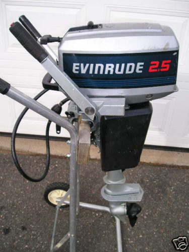

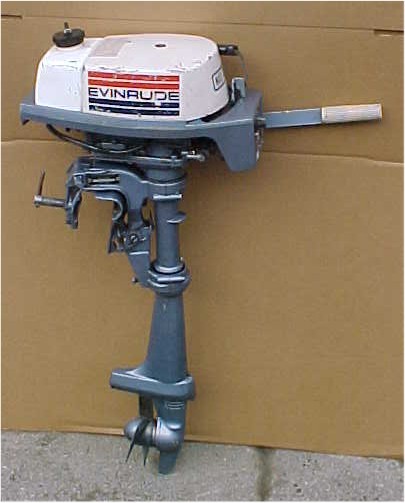

Those old 2-stroke Evinrude/Johnson 2 HP models (1990 or older) are often found o neBay or Craig's List for reasonable prices, fresh-water used ones are still in great shape even when 30-40 years old. In 1987 and 1988 J/E also made a 2.5 HP that might be worth looking at. I don't know how well it will fit since the powerhead is slightly larger than the 2hp that I had...might be slightly smaller than the 2.3HP I had.
