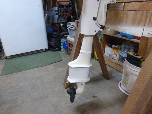

Shaft length is measured from the top of the mounting bracket saddle, where it fits over the transom, to the cavitation plate just above the prop. 15 - 19" is std shaft - 20 - 24 = long shaft, 25-29 = X long shaft. sounds like you have a std shaft motor.
It's a lot easier to find a good used std shaft, so I've purchased one of those in like new condition and added the 5" extension kit to make it a long shaft. that's how the factory did it, so these are factory OEM parts. e-bay often has both new-old-stock as well as used "kits" to do this. it's an easy conversion if you have basic mechanical abilities. I paid $150.oo for a new-in-box kit for my like new 3hp Johnson.
Also easy to tell at a glance (at least on Johnson, I never noticed Merc.) because when an extension is in place you'll then have two cavitation plates, as shown below. one original and one on the new extension ;) .
