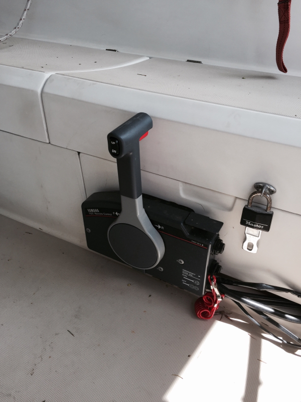

I just installed a remote throttle on my O'day 272. I opted for the full control binnacle with throttle, shift, key, power tilt, cut-off, and fast idle all in one unit, like a motor boat. I bought the unit to control my 2012 Yamaha 9.9 High Thrust 4 stroke. Wonderful engine. It had a tiller with all controls on the tiller.
The 272 has an aft-placed fuel locker on the starboard side in the cockpit. The fuel locker has a panel as a front with room for hoses to pass under and into the locker, and I imagine for fuel to drain out in case of a spill. I mounted my binnacle on the panel and ran the cables under the panel and theought the rear wall of the locker into the below deck space under the cockpit. Thus, when I am standing at the tiller, the throttle is at my right ankle, in the cockpit footwell.

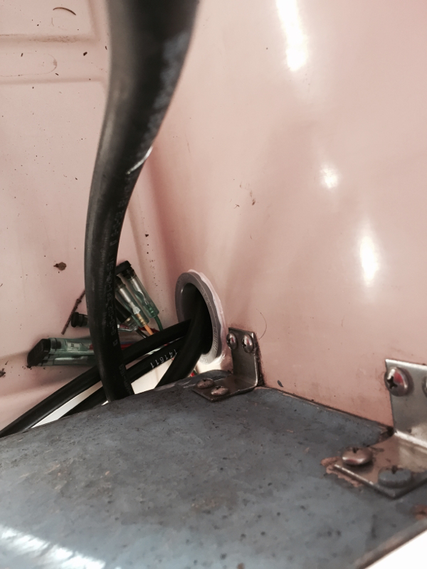

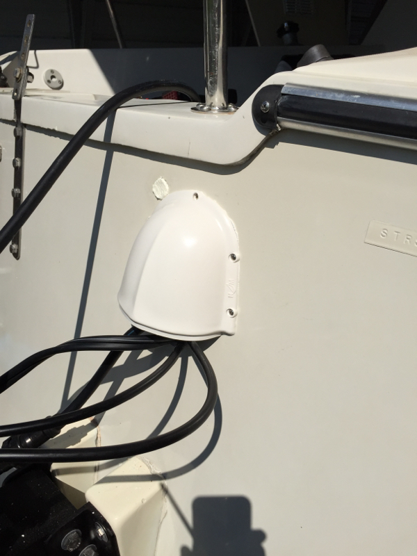

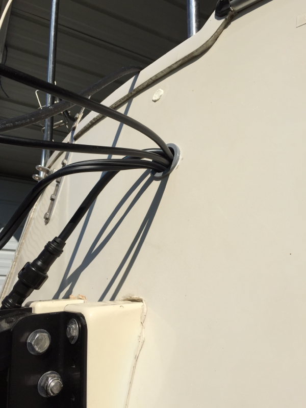

I cut a 2" hole in the rear wall of the locker and in the transom to accommodate the control cables and the electric cable: image-1726417323.jpg

This project took 2 hours on the motor side because there is little clearance for any tools. It took another 2 hours on the boat side. I used 1 3/4" electrical box adapters from Lowes as grommets in my 2" holes. I epoxied them in, and they look great. I am able to raise and lower the motor as well as steer it, but since I removed my motor tiller, I tightened the motor to stay locked. I am also able to lift the motor on the (new) motor mount.

Here are the other pictures of my remote throttle installation.
The first is the throttle.
The second is where I installed the grommet for the cables to pass through in the back of the fuel locker.

Andrew, That is a pretty slick set up. A couple questions. Did the throttle and shifter cables come with it or were they separate purchase? Do you push it forward into gear, then the further you push the higher the throttle? A quick look at Amazon shows a much better price than I would have guessed. Nice job!
Thanks for the compliment! I called my local Yamaha Outboard dealer, and they ordered all the parts for me: Control binnacle, control cables, and wiring harness at the motor side. They gave me a choice of control cable length. 6 ft was the shortest available. I used the 6 ft, and it is pretty much a straight line to the motor with a little bend / slack inside and outside the transom. The cables did not come with the control binnacle.
Yes, I squeeze the lock lever, slide the lever forward into gear and then continue forward to increase throttle. For reverse, I slide the lever back into gear and then continue back to increase throttle.
I just installed it, and the boat gets launched Saturday. I am excited to not have to dive over my transom to start, choke, throttle, or shift my motor.
