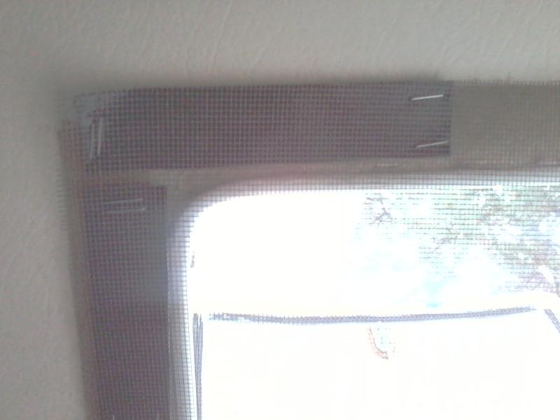

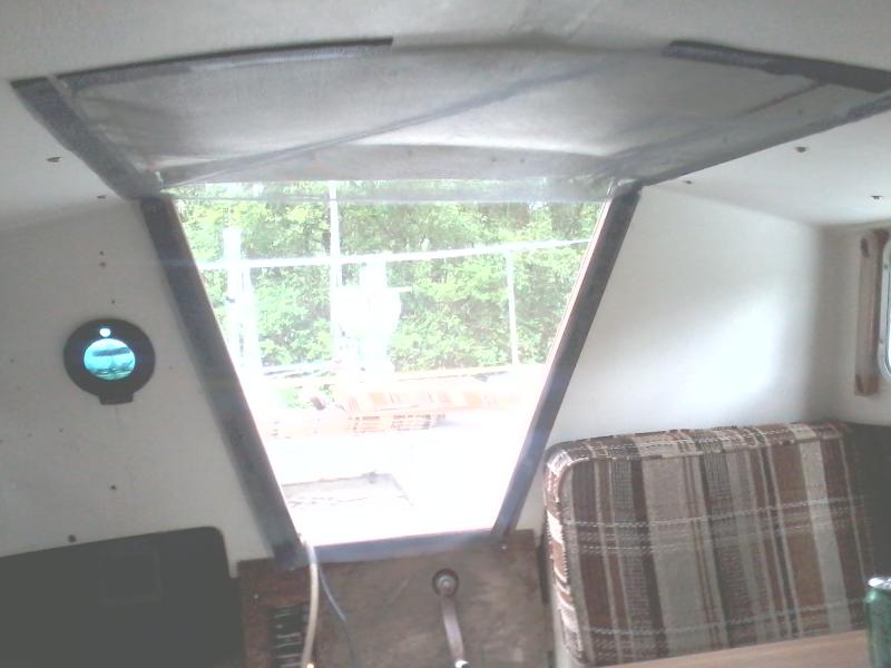

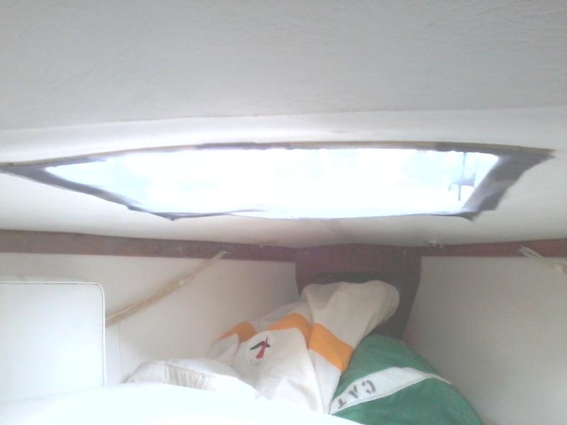

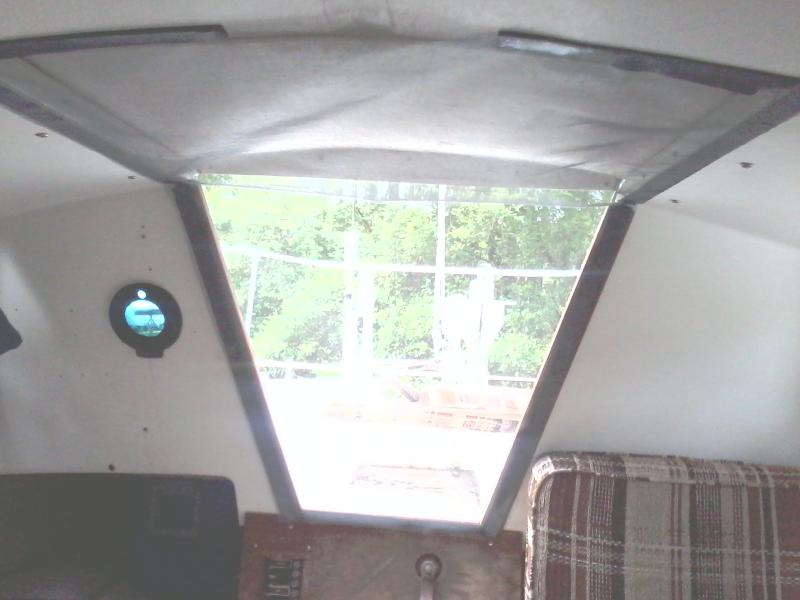

A PO had some white Velcro around the front hatch base so I just took off on this project last night and it's done!
Pictures of my mosquito screening. I ran out of Velcro, that stuff is almost $6.00 a 3 foot section! There are sections I'll have to fill in later with pieces of Velcro.
Both sides of the Velcro had tape backing but the ends of the Velcro, I stapled to the plastic screening. I would say I got about $35.00 in this project, all materials came from Wal-mart.

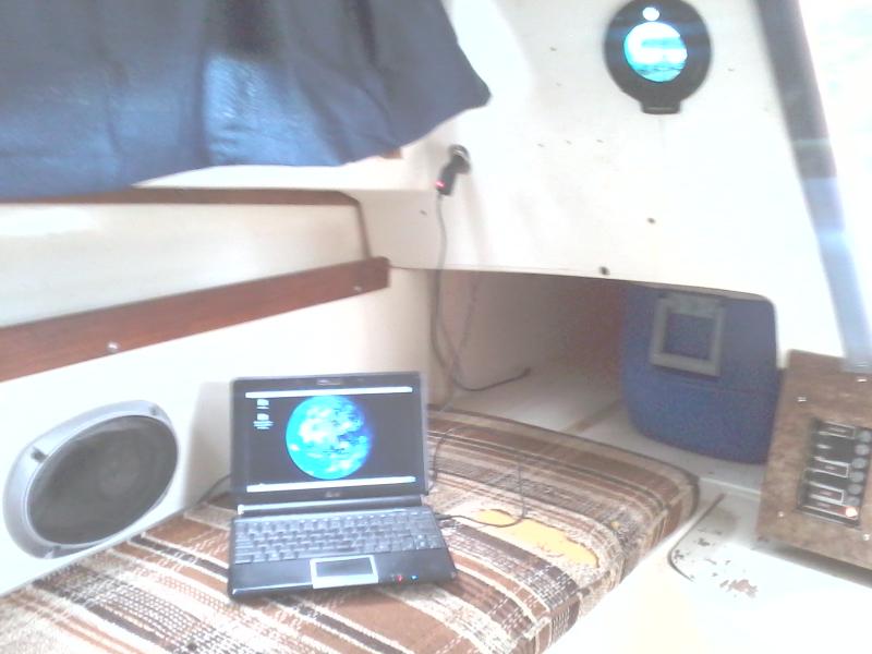

As you can see in the pics, there is a DC outlet on the bulkhead, my Asus PC1000 has a depleted battery but has a DC power cord that came with it. I have pdf copies of the NOAA charts on it, going to give it a try when I hit the coastal area.

Not at all! I have seen that commercial and i saw some on CVS on the "As seen on TV" isle. I thought about that but being as my cabin door is angled and not straight down? I figured velcro was better since gravity would pull the screen straight down.

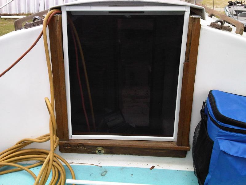

I made replacements for the companionway crib boards that have screens in the middle. 2 layers of 1/4" ply with a layer of screen in between. They don't seal the top, though, like yours does; I like that about yours. Instead we put the hatch cover on and use that to cover the opening.
On the plus side, if we need to get out it goes clunk instead of rrrrriiiiiiiiippp! :D

Your blog is famous among this site and I've enjoyed reading it! I made some screens similar to what you describe in the past only I used a framing kit also provided at Wal-mart that you cut the framing, there were end corner pieces and the screen fit down in a groove with a tool and a rubber stripping sealed the screen and held the framing together. Like you, I just shut the hatch. One good thing about that design is that if I enter the cockpit from the cabin, you can just reseat the frame design and close the hatch, but the downside is with my current design, storage is much easier, I just roll it up. I am trying to figure out how to close the screening from the outside.
