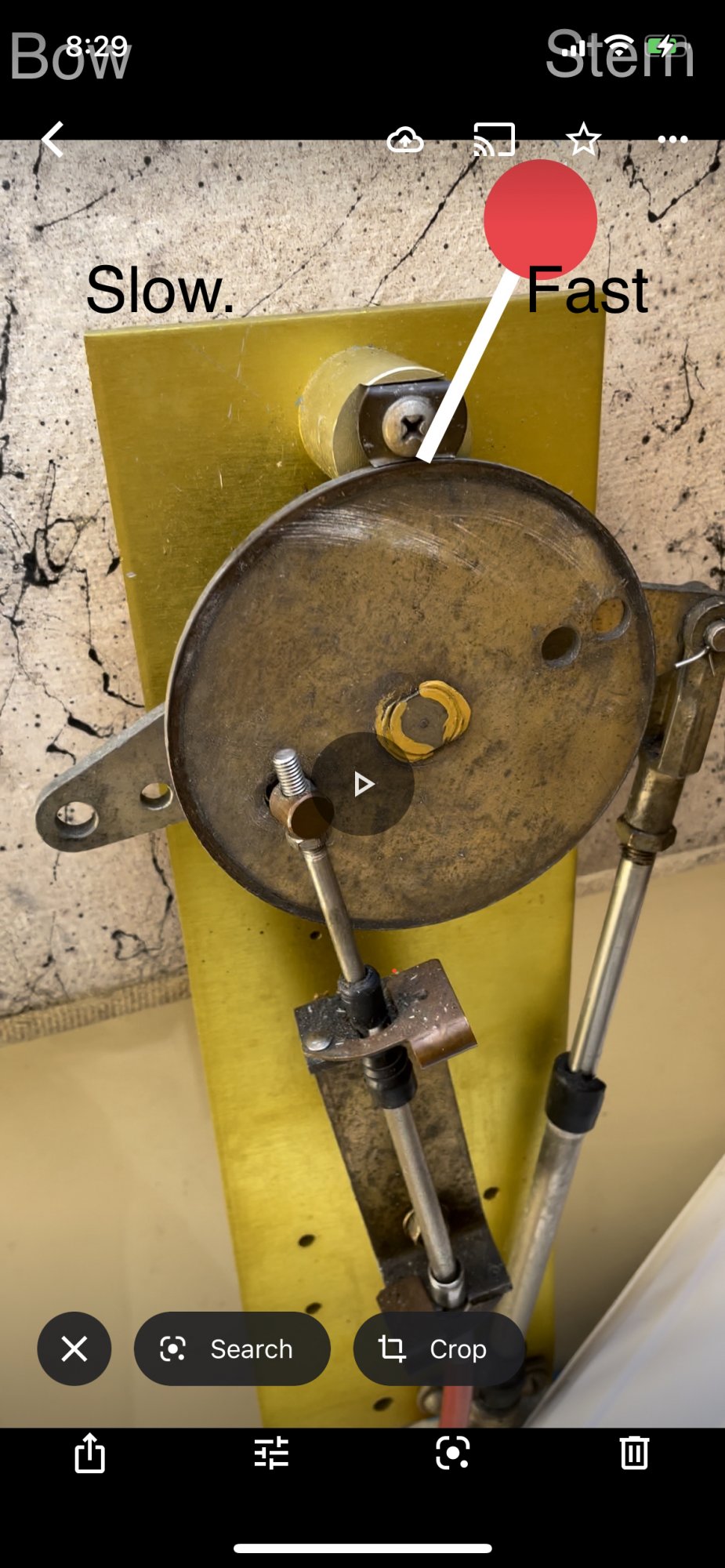

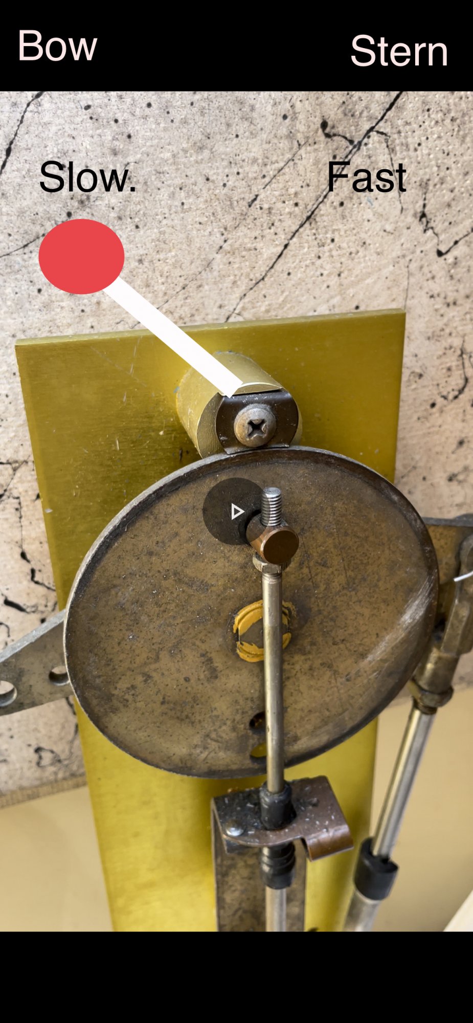

Hi all
i have a 1980 Cat 27, inboard diesel 5411 engine, with Morse dual lever Engine controller
The current throttle set up is Push to slow down / Pull to accelerate which is counterintuitive for ME (I’m sure plenty of you are ok with it)
Has anyone found a way to modify to Push to Accelerate?
Thx all

If you open it up, it is likely that there is another possible position for attaching the control cable. Move the cable so that it works the way you want it. There may be a cam or wheel.
The gear shift lever will have 2 wings to do the same thing.
I actually looked at the control gear. The throttle cable is attached to a wheel so as you mentioned there might be a way to switch the cable anchor point on the wheel.
but there s a indent on the wheel that serves a purpose and if I move the cable then the indent will lose its function
thx a lot!
