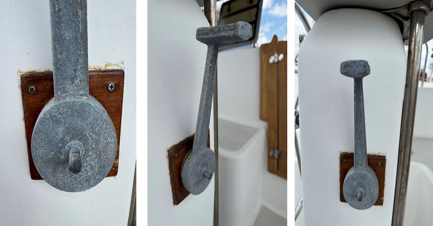

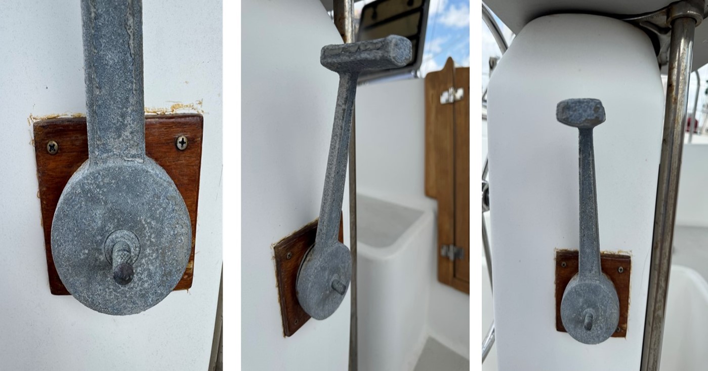

The throttle mechanism works fine. The handle/lever is very corroded. Wanting to replace it for aesthetics, only. I will post a couple of pictures.

The lever, is aluminum and is very corroded. No fixing this thing. I’ll pictures later. Thanks everyone.

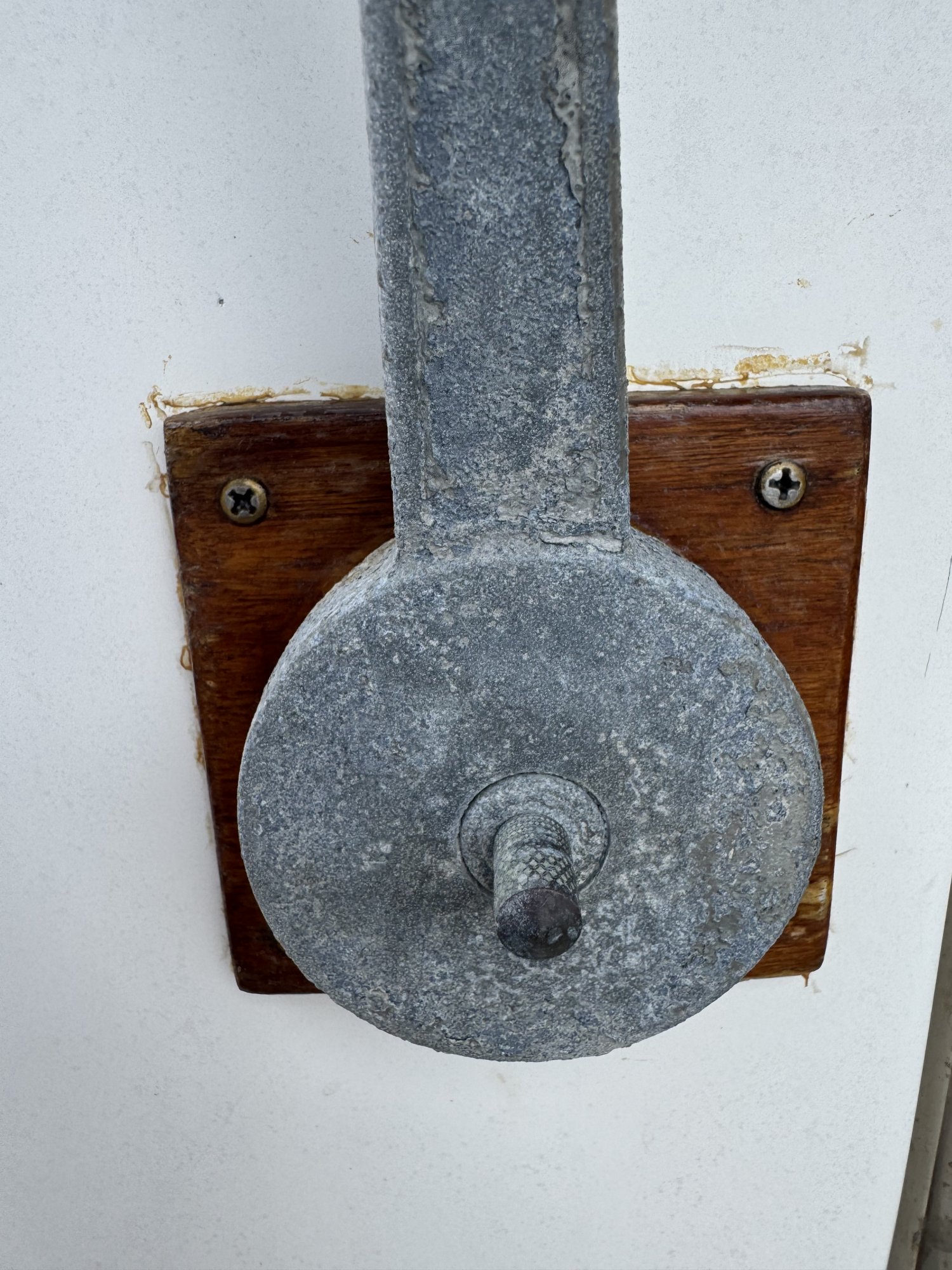

I see what you mean….I doubt that thing could be polished up.
Doesn’t look like anything I have seen. Not sure it is original to the pedestal either.
You may have to take it off the shaft (hopefully it will come off), and see what sort of shaft it fits on (square shaft, size?) and also see if there are any identification marks on the throttle lever (inside the pedestal) and maybe that leads to something. If nothing else, with the shaft shape/size, maybe you could have one made.

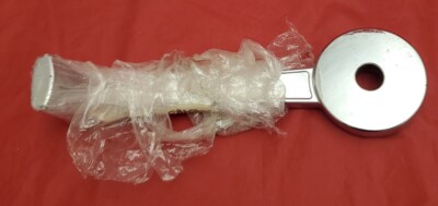

If we could see the shaft and how the lever engages, we could see if something like this would work…
Morse is a common marine throttle manufacturer and this one says “vintage”…

You should lie down in the shade and rethink this. That's vintage cast aluminum, they don't make 'em like that anymore. It's not broke, you are the only person even notices it. That can't be the ugliest thing on your boat demanding attention is it?
13,545
Good advice once he sees the replacement cost for a new shift.
There should be a set screw on the bottom of the handle. Put the handle all the way forward or back and the screw should be visible. If the screw comes out, then the handle should just slide off the shaft, although the corrosion may make this a bit challenging. Once off, try polishing the handle. If that doesn't work, then the handle @Tally Ho or a similar one should work. If the handle doesn't come off, then your options get more limited, live with it or by a new shifter.
The button in the center of the handle should push in so that the engine speed can be increased without engaging the transmission. If that button doesn't depress or is very hard to depress, remove the whole unit and try cleaning it up and inspect the cables while it is out.
