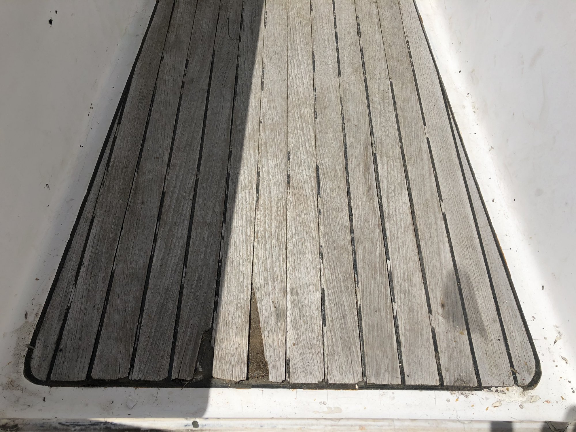

Both the teak and the caulk are failing. This is strictly in the cockpit sole, where some water can collect. I'm guessing the sole pan is intact. I see no water ingress, but I should really double-check in the engine compartment. Apologies for the lack of pix. I'll try to get some in the near future. In any event, thanks for responding. At least I seem to be posting correctly.

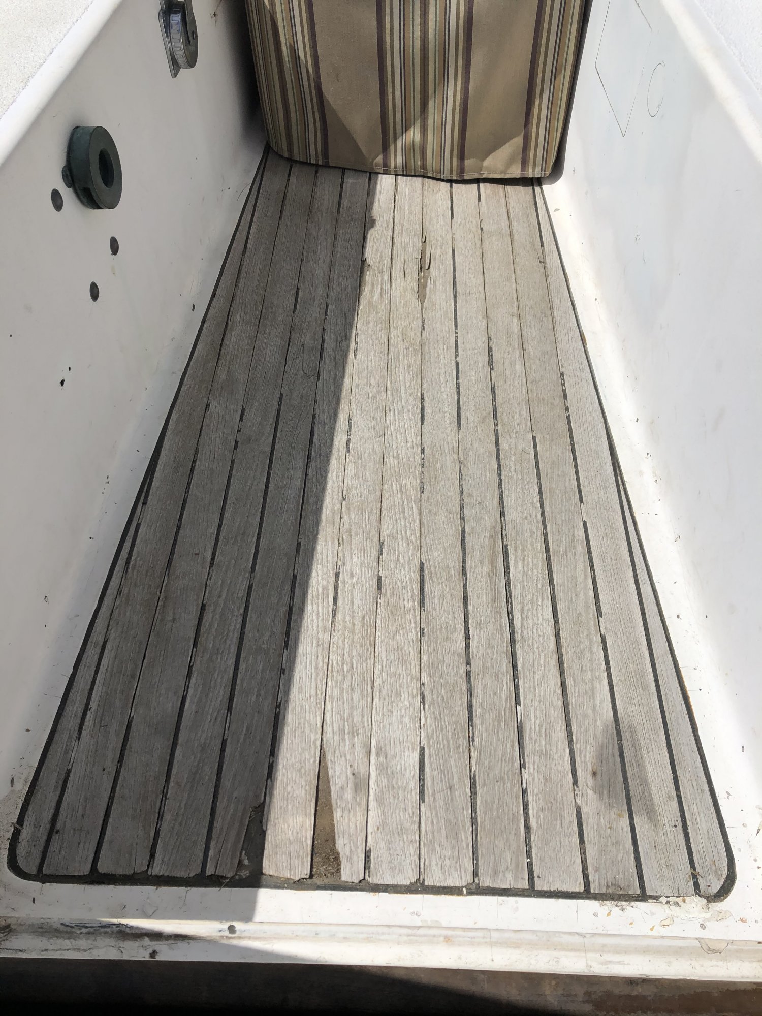

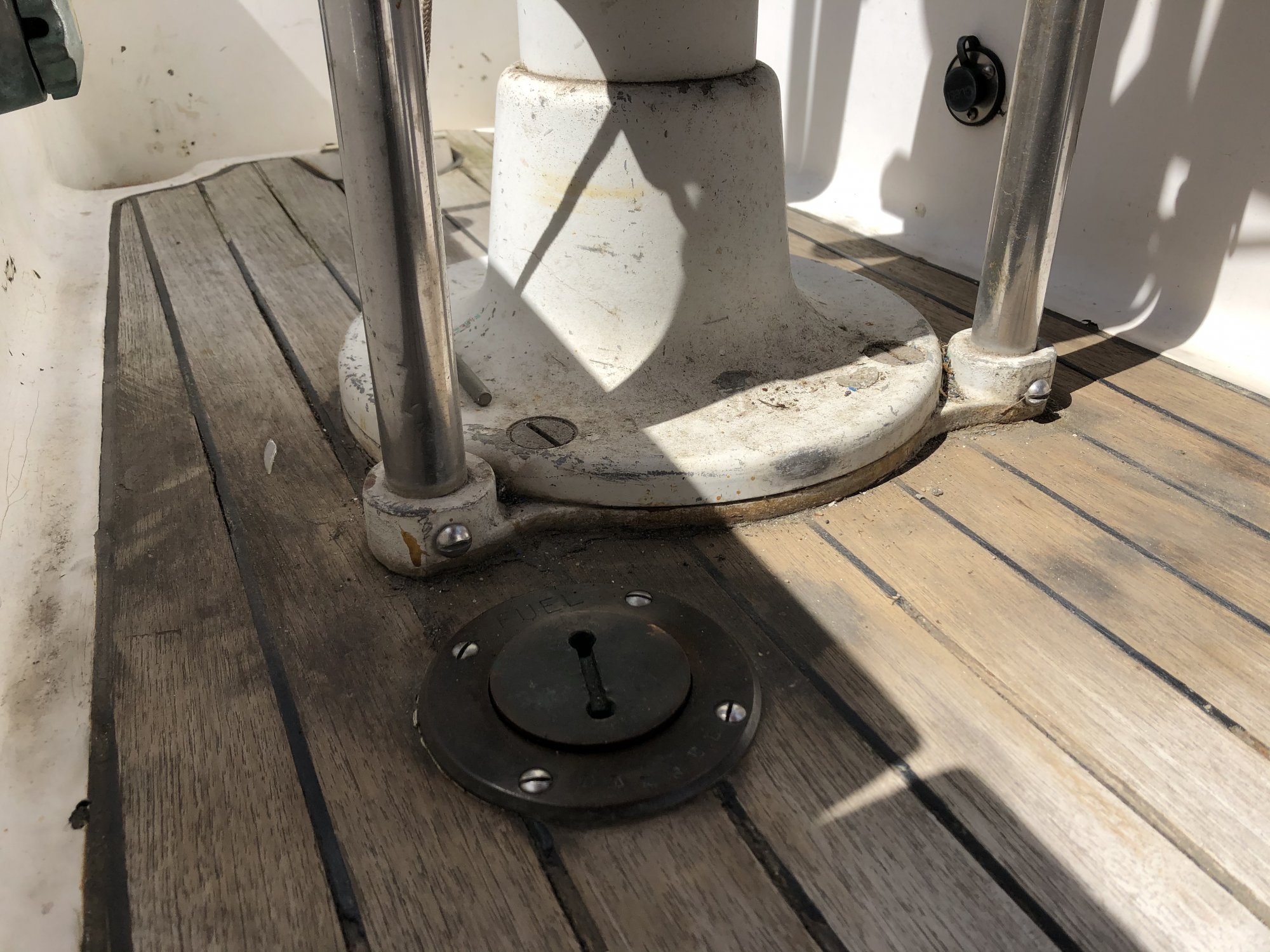

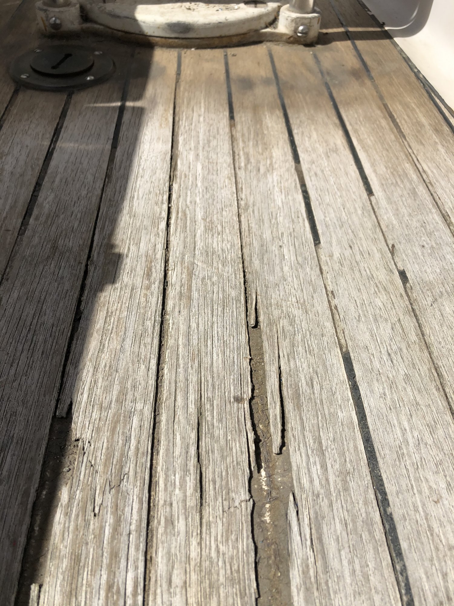

Great high-resolution` photo work!
Zooming in, I can't see any obvious wood plugs that would be hiding fasteners. That could be good. Maybe an adhesive was used to hold the teak veneer decking down to the sole? Fastener hole through the fiberglass skin and into a balsa core suffers water intrusion as the teak begins to wear and thin.
Then was the cockpit sole cored, and if so with what material? Is info available from a Morgan owners group online?
My guess is, when you make the repairs, you'll want to: Remove the binnacle, scuppers and fuel fitting. Remove the teak decking. Then if you're lucky, you may just be able to re-install new teak veneer decking, caulk, and have a beautiful cockpit sole.
If the core is water saturated then you'll have the extra work of repairing that first. At that point, you may even consider just glassing the sole over the core repairs and skip the teak.

from your photos, that will be easy to repair. a bit tedious, but no big deal.
take an old file, bend the pointy tip over 90 degrees, Carefully and slowly dig out the weathered black caulk while trying not to widen the gap. then with a router and/or a chisel cut out worn wood area. doing so while not going any deeper into the wood than needed. then take a thin piece of teak and epoxy into the area. this is called an inlay. now buy a tube of the black teak deck caulk and recaulk the gaps. if the caulk is a little higher than the wood, don't worry. the caulk can be trimmed with either a razor blade or sanded down with a belt sander.
the inlay looks like it will be about 1/8 in thick, maybe less.
if your not hobby carpenter, hire one.
once done you'll never notice it after it gets a little weathering.
