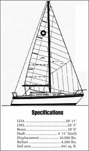

Most sailors don't like to talk about adding HP to their boat, however as we begin another stage in our lives, we are looking at more ease in movement via motor. Our 1978 30' O'Day weighs 12,000 lbs and has always been considered under-powered with the 12 Horse Yanmar (3 knots top speed in good conditions). My question goes out to anyone who has replaced an engine in that type of boat as to how many horses I should bump up to if replacing the Yanmar 12. Some have mentioned 25 HP, while others have suggested electric (a bit expensive to retrofit, and early in it's use). Last year I went from a two blade prop to a three blade. Gave me some quick bursts, but only increased drive minimally. Again, we are looking for power for longer motoring and a slightly higher rate of speed, with the power to face a thunderstorm if necessary, or to push myself through some silt on the river bottoms in our travels. Any advice will be welcomed.

Practical Sailor has an O'day 30 review that includes your engine and how it's mounted. Worth a read

The attached Practical Sailor article talks about the engine hp from early O'Day 30's of 12 hp and then 16 hp. Understand later models may have installed a Universal 18 hp engine based on one O'Day 30 sailboat data site. I came across the article below that provides a formula for calculating motor hp (for outboats) for sailboats as a function of displacement hp = displacement / 550. That is closely confirmed by the Cruisers Forum thread below. Some O'Day 30 owners in this forum will likely offer their engine motor hp recommendation and experience.
