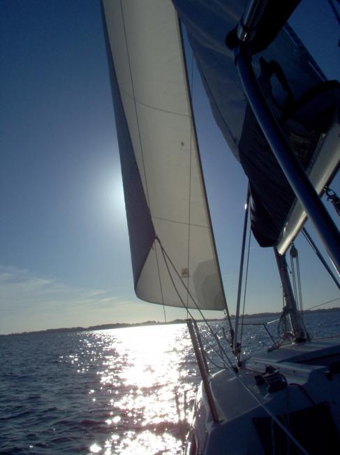

although i'm not interested in racing, i am interested in being able to sail in all kinds of wind, including light airs. i also like going fast! so, i'm assuming a multipurpose sail , genoa, or spinnaker of some sort would come in handy. since these are expensive, i was thinking of starting with a used one and going from there. since this is a new design, isn't it ok for me to get started with one that was made for a substantially similar boat before i drop $600-$1,000 on a new sail? Thanks!!!!

There are some Hunter 23 sails for sail in the gear ads, One is a 150 genoa and should fit your boat pretty close might be a few inchs too short maybe 6 but nothing a additional piece of line to extend it wont fix! its b/o too so should come cheap! Good luck

Isn't that 25 a very shallow draft boat? If so you would be better served to get a down wind asymetrical chute instead of a bigger Genoa that wil ust lay you over on your side. None-the-less go on line to Bacon Sails assuming you have your rig measurements and you will probably find a good deal in the off season.

between used and old. Old sails may be cheap but they are usually streched unable to attain forward effort and generating heel instead. Good used sails usually command a price close to new but discounted 10% to 20%. A 2006 working jib will outperform an old blown 150% Genoa. Learn to trim and get the most out of your sails and then consider perhaps an assymetrical chute to enhance downwind performance.

Your pic shows the jib riding nearly 3' up the furler extrusion. pull that rascal down closer to the deck and maybe add a traveler track and car. Make sure you've done all you can to enhance what you've already got. I sailed a 240 for a couple years and tweaked it for all it was worth including new hardware and a new asy spin and dousing chute (that I hardly ever used). After getting used to the nuances of the 240 I traded up to a newer 260 and the process started over again. That 25's a fine boat but don't be too quick to add used sails that arent cut just for your boats dimensions. Benny's got it right. Tweak what you have and only then add a new chute cut for your boat. Good luck. Michael 2004 H260 s/v "Plan B"

The jib is cut like that for a reason. It's a cruiser's cut. So you can see better. Pulling a jib with a cruiser's cut down would actually hurt performace because wind is faster higher up.
