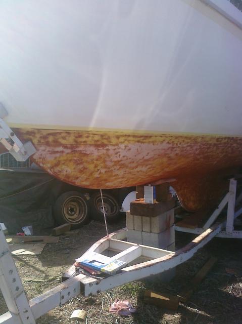

I have a 79 Catalina 25. I sail in freshwater only. The boat will be on a trailer except for weekends and maybe one week out of the summer. The bottom on the boat now has been stripped from what I can tell. I have no idea what was on it before(no previous owner). My plan was to just barrier coat it with interprotect 2000 and be done with it. Will the barrier coat get chalky after a year or should I put a topcoat of something over the barrier coat. I know I don't need antifouling but what else would you paint over the barrier coat?

i understand that i really dont need a barrier coat, just like i dont need an antifouling, but the bottom has been stripped/sanded almost all the way down to the fiberglass weave in some spots. The bottom definatly needs a barrier coat, to reseal it, but also to make it look acceptable. I've also removed some thru-hulls and patched the holes, so im also looking at the barrier coat to cover all the cosmetic blemishes.

I will definatly be barrier coating, not only to protect the fiberglass from osmosis, but to also give me a decent cosmectic surface. I'm basically wondering if the barrier coat will get chalky like all epoxys. If so then what paint can I put over it to keep the bottom smooth and shiny that is not an antifouling/ablative.
