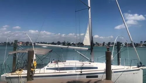

I can give many good reasons to own a trailerable sailboat. :)
Mooring whips would be used if you owned your own dock or had permission if you had a slip? Judging by pictures, they are hard mounted, quite strongly.
Oct 19, 2017
8,051
Out of scores of images online, this is the only one I found of Whips being used with a sailboat.
