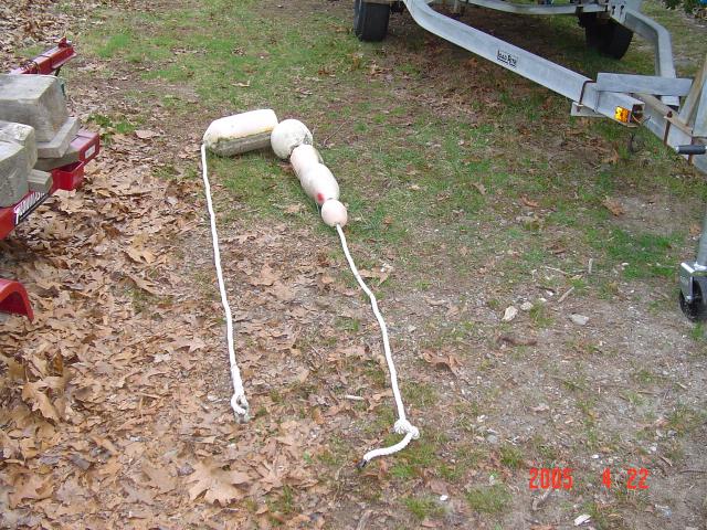

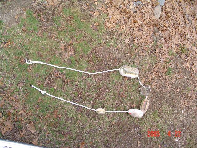

You only need one pendant line which is attached to the chain on the mooring ball. The pendant line is usually made up with a metal thimble spliced on one end of the line, in which you would want to connect to it via the chain with a shackle. The other end of the pendant line can have an eye splice if you prefer, to go over the bow cleat on your boat. A good rule of thumb for the minimum length of the pendant line is; the measurement from the bow chock down to the waterline of the boat X 3.5 + whatever line is needed to go to the bow cleat. You can go a little longer with the pendant line if you like, but never go shorter. I would go with a three strand Nylon line of about 5/8" or 3/4" diameter, or go with a braid line. I use 1/2" Nylon three strand line with a thimble and 1/2" galvanized shackle which I tighten down real tight, and wire with stainless steel wire, or I use a plastic zip tie to secure the pin to the shackle. I do not have an eye splice on the other end. I tie my pendant line to my bow cleat. If you choose to use an eye splice, you ought to also tie a thinner diameter line over it on the bow cleat to prevent it from slipping off the bow cleat. There are two kinds of mooring balls. The old type of mooring ball has the metal hardware on it which consists of a 1/4" rod that goes through the ball with a large eye at the top. The mooring chain is attached to the bottom of this rod and your pendant line shackle wants to be attached to the shackle or chain and never the large ring on top of the ball. Then you have the newer mooring balls that have a hole through the ball in which the chain goes through and has a rubber stopper and a large shackle on the end of the chain on top of the ball, so that it doesn't slip out of the ball. You can attach your pendant line shackle to this mooring ball shackle. Just make sure that the ground tackle is good and that all shackles are tightened good, and the pins are wired to the side of the shackle. If you use more than one pendant line there is a greater chance that they will rub and chafe right through. You could have someone make you up a pendant line in the shape of a Y with two eye splices near the bow to go over both of your bow cleats. You may want to check with local city and town codes on mooring requirements before you do anything. We have a local harbor master in the town where our club is located, and the town has certain rules and regulations for moorings, ground tackle, and pendant line sizes for different size boats. Where I moor on a tidal river that leads out to the bay, the current is forever switching directions and the boat may be pulling to the North or the South depending on wind and current strength. I use Styrofoam fish trap floats threaded on my pendant line along with a stopper knot at the end, to hold them in. This prevents the pendant line from sinking and wrapping around the mooring chain. I learned how to splice three strand rope years ago when I did line work, and today I do all of my own splicing as well as free rope splicing for our yacht club members as a courtesy to the club.
