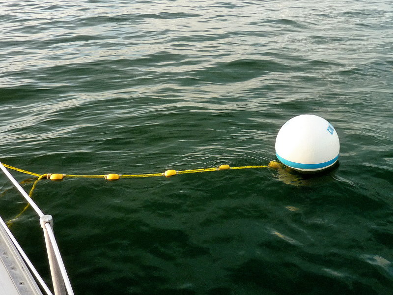

We use a large white Polyform ball, that we paint a blue stripe on, and they last about 10-12 years.
This photo was take in 2013 and that Polyform ball is still going strong..
12,672
Is the blue stripe because it looks cool or is there a functionality to the upgrade?

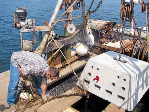

This is the typical pre cast concrete mooring that's used around here. As you can see, the bar is simply a solid rod. It is easily replaced through a side cover. These moorings are marketed as habitat for marine life (that's a phony lobster stuffed in there,...) so they're pretty popular.
If you have to replace the staple or rod often, these might be a good $$$ saver in the long run as a diver can replace the bar with ease and the mooring block itself, would be permanent.
They are pricey though if only due to shipping the heavy freight. Granite on the other hand is readily available around here as it's mined and used for marine sea wall construction regularly.
Good luck!
