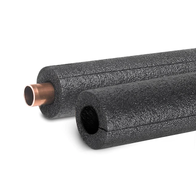

I took some of that pipe insulation you can buy at Lowes and zip tied a few piecs around my boat hook. Did the same for my winch handle.... and it has already saved me one winch handle....:facepalm:
