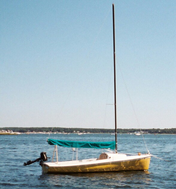

I'd partially lower the CB, maybe about 1/4 to 1/3 of the way down. I'd remove the rudder completely and stow it below or at least in the cockpit, although with the tiller tied on center and the rudder kicked all the way up... it might act as a sort-of "anchor sail", think of the fin on a weathervane. Leaving the rudder down will cause more wear and tear on the rudder and may cause the boat to frequently "sail" up on the mooring, and possibly result in the boat getting hung up on the mooring and even pointing downwind if rudder gets caught on mooring.

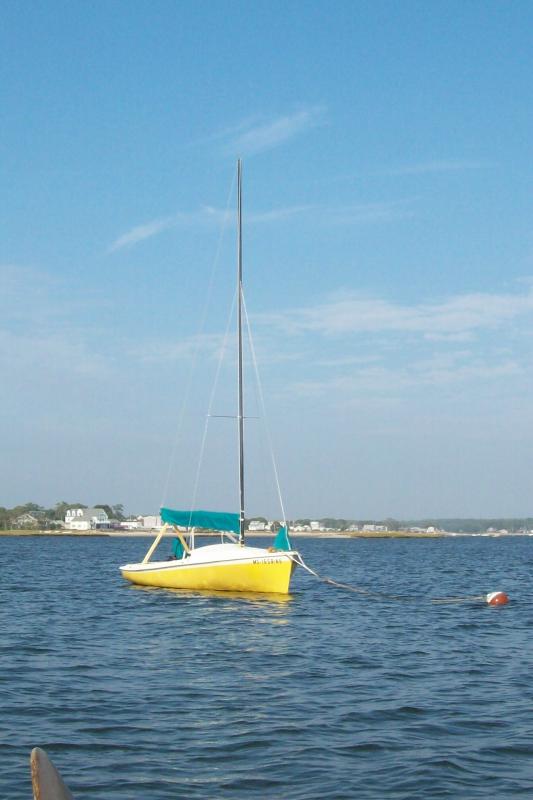

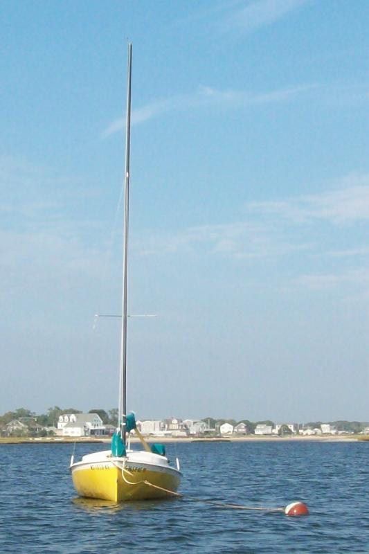

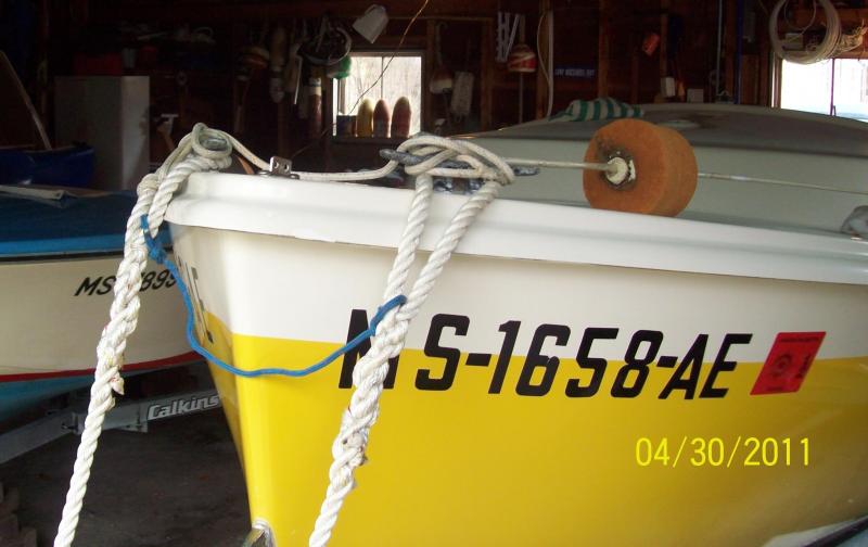

On my DS II, I have the CB slightly down (about 14-18" deep), remove the rudder, and my mooring has a bridle on it with one eye-splice for each cleat. The bridle centers the mooring pull better and reduces the "sailing around" on the mooring.
My mooring is typical for my area, anchor (I use a 100# mushroom), then 10' of 1/2" chain (about 1.5 average depth of water at my mooring) ,then 8' of 1/4" (or is it 3/8"? I better measure!) to the mooring ball, and then a 7/16" double-braid Nylon pendant (5' long) with a short bridle of 1/2" 3-strand nylon, as I say, one loop to each of 2 bow cleats. We have a 4' tide change twice each day, so depth varies from just under 3' at low tide to around 7' at high tide.

I wouldn't think a shorter pendant would cause the problem, as long as it isn't too short (recommended length is usually 2.5X the distance from deck level at bow to waterline + distance from chock to cleat) Since, like my boat, yours has the 2 mooring cleats out on the deck edge, 2.5X the freeboard at the bow would be recommended length (mine is a bit longer than that, but not much.... I estimated length in my previous post, it was only 1 year ago that I made the pendant, but already have forgotten exact length!) If your pendat is less than 2.5X the bow freeboard....that might cause some of the sailing around at the mooring.....(theoretically?) since the boat can't settle far enough from the restraining point (mooring float) to lie properly to the wind..........(OK, I guess I am starting to "grasp at straws"?)
More pics, this time showing my mooring pendant that was new last year (2011)
I'm beginning to wonder if my sail cover forms a sort-of "anchor sail"?

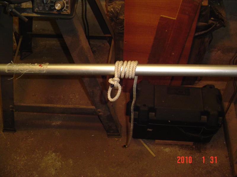

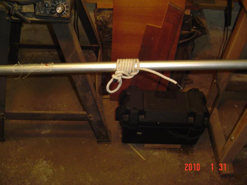

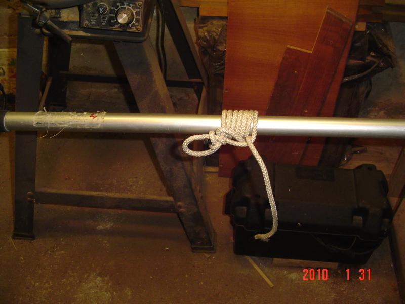

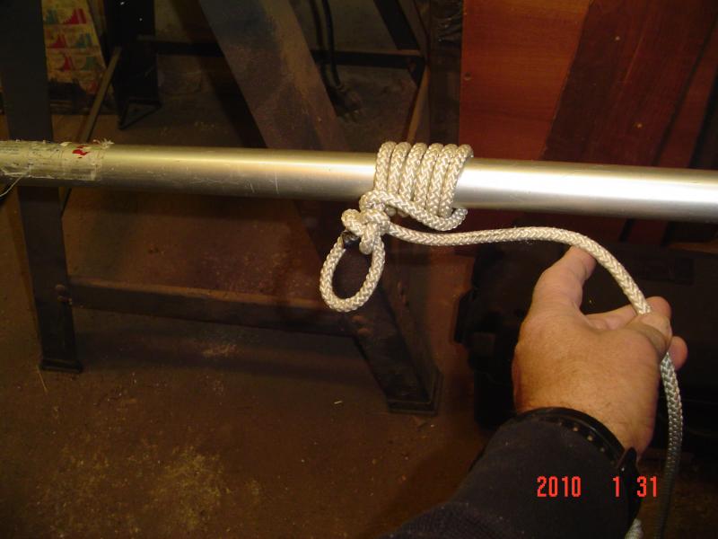

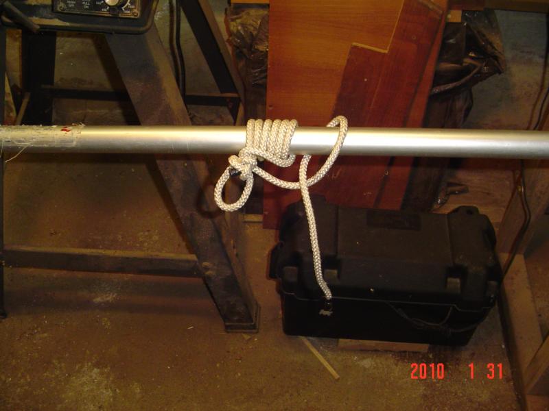

Learn this hitch. It's very simple to tie and it will have a hundred uses. You don't need the loop or bowline on the end, but this is the end that would cause the wraps of rope to tighten down on anything and grab hold of it. Just take about five or six wraps around a rope, or wire, or anything, and take the rope back between that object and the standing part of the rope. Then come back with the line and tie two half hitches in front of the wraps that you made. You can move this hitch forward or backward with your hand very easy, but when you pull on the standing part of the line, the hitch stays put.
Joe

Thank you Joe for the helpful knot. I must learn that one.I think it is a climbers knot as well.
