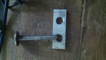

Be aware that the bow eye may not be as strong as you hope unless you reinforce it. Here's what I found behind mine!! An aluminum backing scrap wallowed out terribly by the factory installer and nearly pulled through. I placed a much more rigid and substantial backing piece in it's place in under 45mins.
All the SS bolts for your cleats and bow rails are threaded into aluminum backing plates so tread lightly unless you find comfort in what amounts to aluminum nuts holding your pride and joy. Here's a pic of the single bow rail/ head stay bolt that was stripped and barely intact for our boat(another easy fix is just to bolt it straight through).
Glad your boat came through Irene unscathed. Mike
