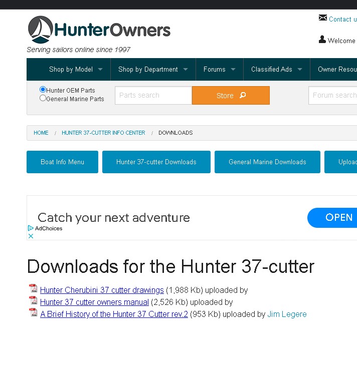

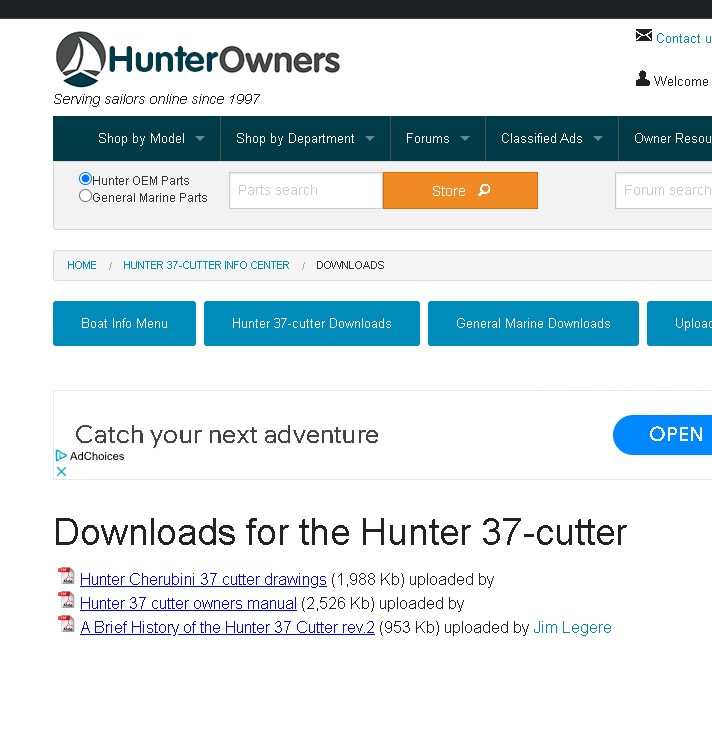

@monoceresin: do your homework! There is a lot of information on the 1978 - 1985 Hunter 37 Cutter here in the archives on SBO. As well, member John Brecher (@Johnb) maintains the H37C database - if you haven't registered with him, you should.
I have added our Hunter to the database.
I have read every bit of information here on SBO that I can find. I have the service manual for my yanmar. Can you point me in the direction of this "lots of information." I've been spending about an hour a day pouring myself over the wiring diagram and identifying every replacable part on my engine. Some of the links that people have commented here are old and no longer work. The current Facebook group has been helpful sofar.

Not my sticky thread; Mathurin started it. Glad you found it. Plugging "H37C" into the Search bar at the top of the page yields 14 pages of results. "Hunter 37 Cutter" yields 15 pages, some of which are duplicates. Lots of rabbit holes to go down. And if you really can't find an answer, just ask here in The Cherubini Hunters subforum. Glad to hear there is some help over on Facebook too. I don't do FB but I suspect its harder to search on social media. Stick with it. You have a boat with good bones.
