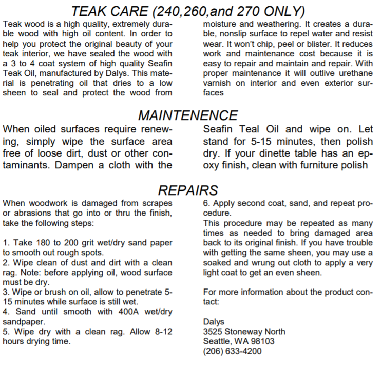

Can someone point me to the Mohawk varnish product to touch up the interior varnish in my Passage 456 built in 2002.
Feb 21, 2013
4,638
Hunter 46 Point Richmond, CA

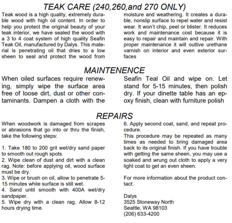

1575213952120.png1575213952120.pngThe following might be useful from my 2005 Hunter 46 manual. That is what I follow. I do not use varnish as it leaves a shine.
