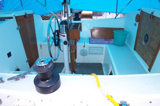

I would welcome advice on modifying a center cockpit for off-shore sailing. The attached photo shows the problem. The cockpit is about 5.5 ft square at the seats. The deck is about midway up the seat backs. The cockpit drains are 1.5 inch and discharge to through hulls directly below the drains. Drainage is too slow to deal with a boarding wave. The main cabin is partially secured by a bridge deck at a height about half way to the coaming level and then with conventional drop boards. The rear cabin door is a "bifold" door at cockpit floor level. I would appreciate advice on the following: 1) Providing for more rapid draining (add 3" horizontal drains through the bottom of the seat lockers c/w check valve or flap valve, directly out of the side of the hull?)2) A design for a more secure fwd companion way top hatch and hatch boards that is either permanent or "for storm only". 3) A design for a secure rear door to the rear cabin to resist both a filled cockpit and wind driven spray. The current arrangement is a security fiction.
