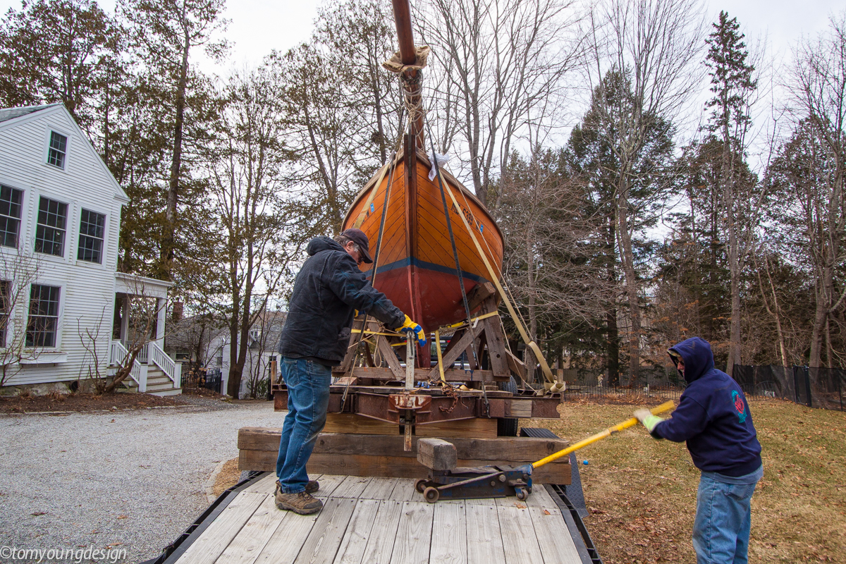

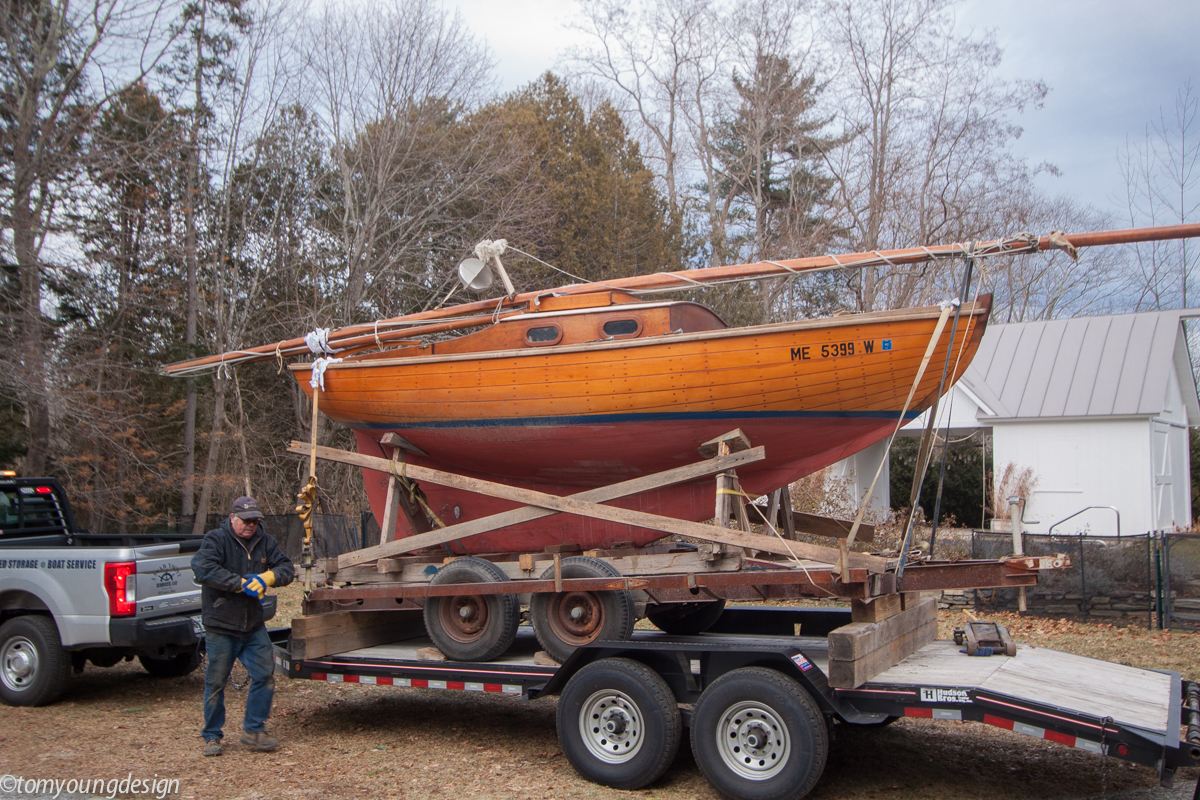

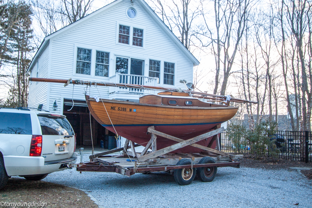

ok good to know, I'll look into a flatbed, I can rent one for a good price, but I'm not sure on how to load it on the trailer and unload it
These guys were experts. The trailer and cradle were too rickety to go down the road. That was all blocked solid to the good trailer and well strapped down.
Once the old trailer was jacked up, the cribbing removed, we backed another vehicle up the trailers ramps.
Dropped the ball and drove it off. 100 feet at walking speed is as far as I would trust this trailer (homebuilt of 2 Studebaker axles in the 70's), to go.

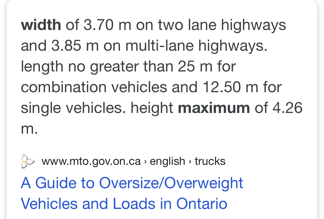

unfortunately the cradle doesn't fold, I know it's 73 inches wide but I don't know the length
Ontario load limits info
