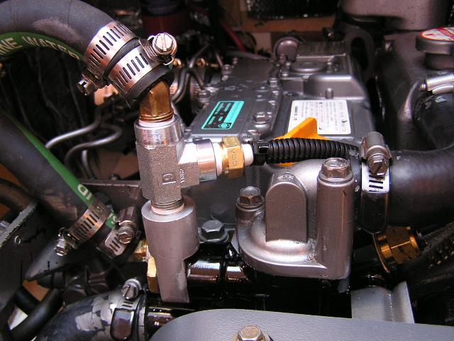

my mixing elbow
my engine has around 325 hrs, and so far no soot and runs great. I have the high rise ss elbow, I will probably check it out next year. So far ok.....Red
