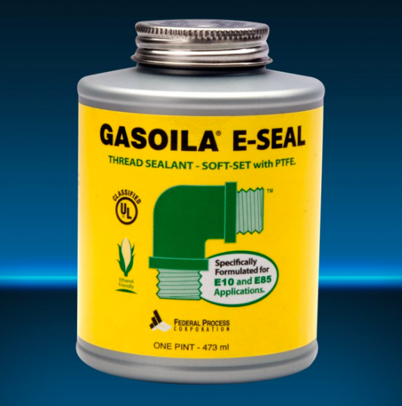

2. The removal of the coupling has always been a difficult problem, sometimes worse than others. This time I got the eBay stainless mixing elbow and did some research for a material that could be used on the threads. What I wound up with was a thread sealant called Gasoila® E-Seal.
http://www.gasoila.com/products/pipe-thread-sealants/gasoila-e-seal-thread-sealant.html
It’s a black sticky stuff and hopefully this will do the trick. It is non-hardening and has a temperature range up to 600ºF
The smallest container is a 1/4-pint which for most of us would be a lifetime supply if only used on the mixing elbow threads. While it has only a one-year shelf life, but …. one can stretch it a bit. The PTFE is a particulate that is in suspension so it will stratify over time. So prior to use, make sure the product is throughly stirred up prior to use and re-use. The $20 approximately is a small price to pay when compared to the cost of the effort to remove mixing elbow and coupling.

Never tried teflon tape - didn't even consider it due to the heat so, have to say, I'm really surprised. With regard to the anti-seize, I did try that once and it seemed to actually have no improvement or even to make unscrewing worse.
All I've ever heard was how difficult it was to get the coupling and the elbow apart.
So, guys, thanks for the option.
As it is now, I've got a lifetime supply of E-Seal!
Hopefully everyone else will read your suggestions.
