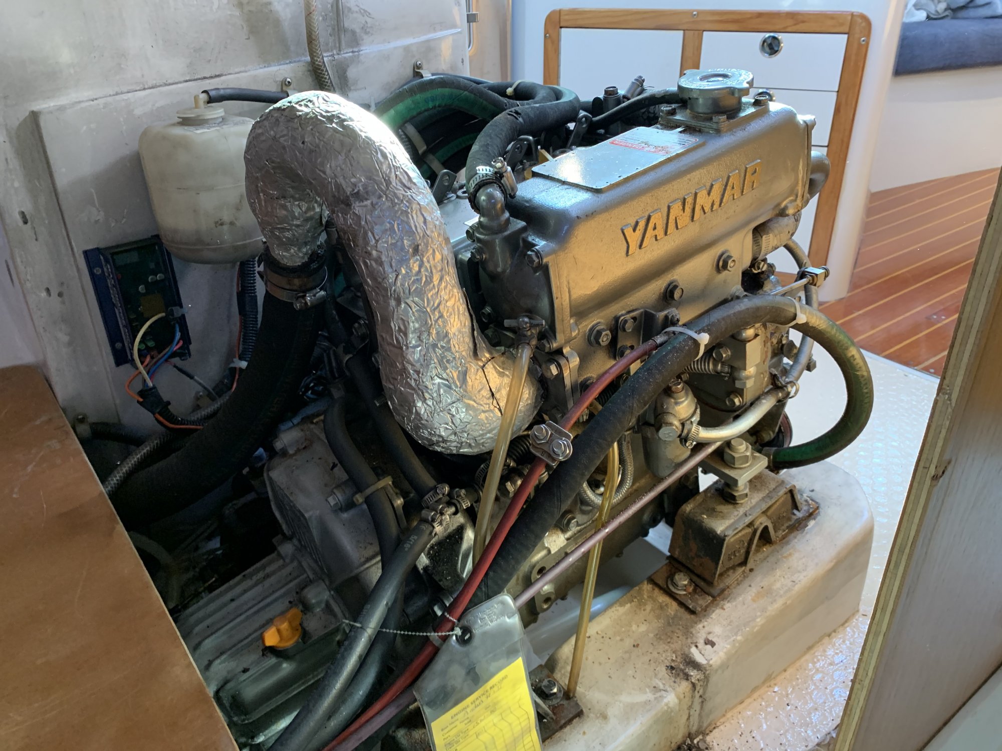

The mixing elbow cracked on our Hunter 310 Yanmar 2GM 20F. We need to replace it. What should we expect? What complications are likely?

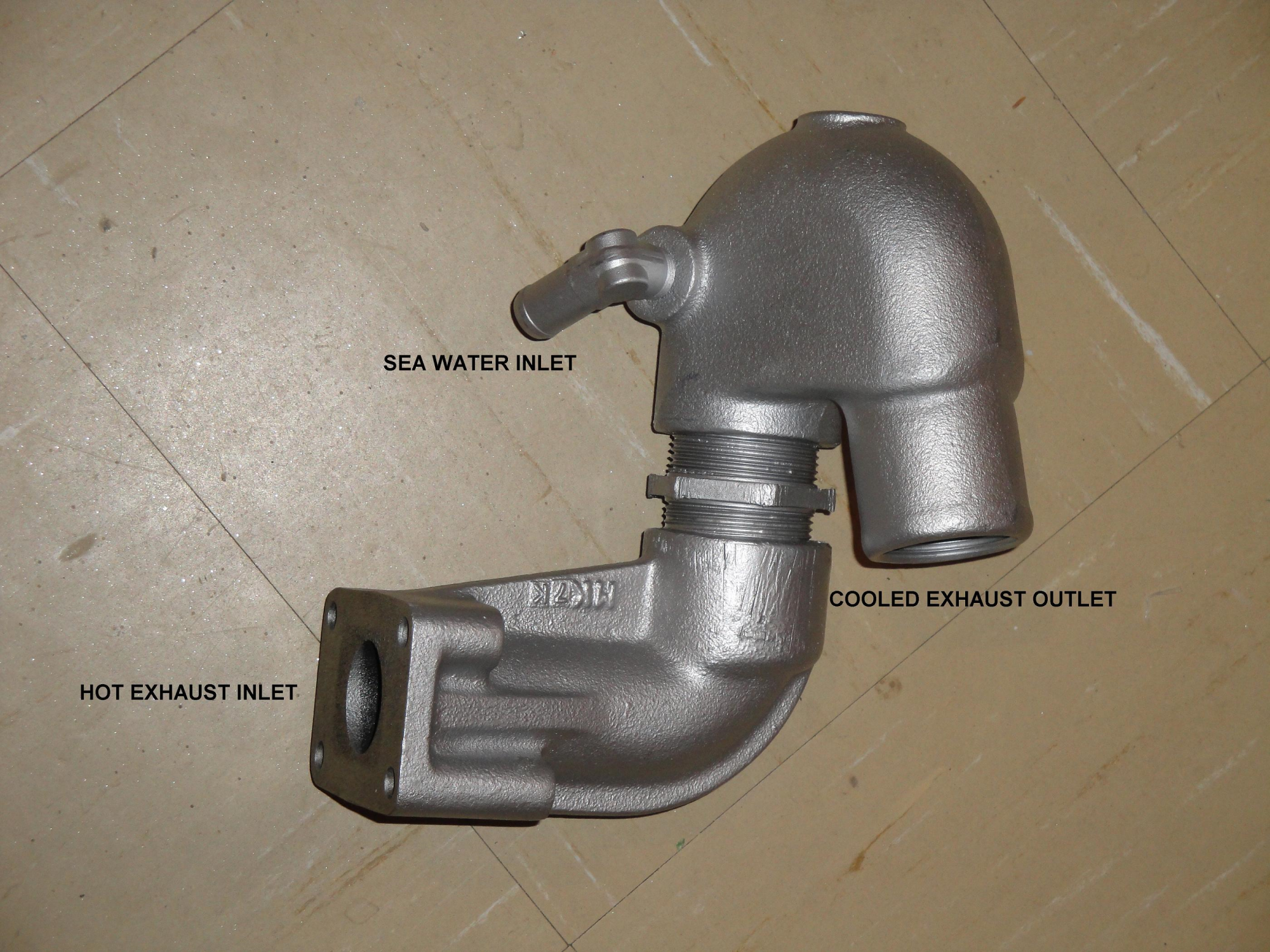

All the advice you have been given here is correct. You will save yourself a lot of work by removing the entire elbow assembly from the 4 bolts holding it onto the heat exchanger, and removing the exhaust hose from it.
On my 340 the was no way possible to swing any type of wrench in that confined space to even try freeing the elbow itself. Spray the bolts with PB Blaster or similar product. Let it sit for a day and carefully unbolt the bolts. You don't want to break one off. Take your time. Once out and on a bench you can then put wrenches to it.
But if it was my boat, I'd replace the entire elbow with new and better materials.

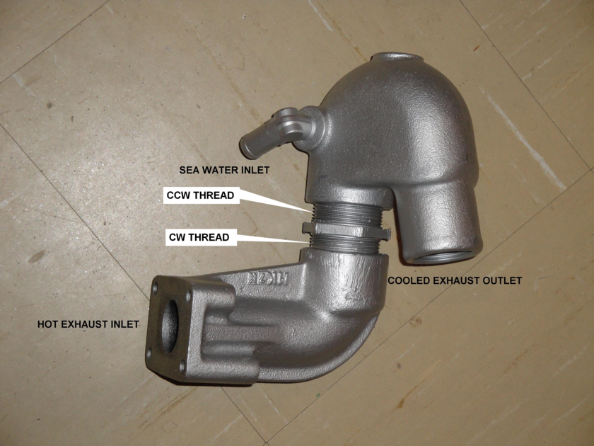

I have some photos of my removal in albums under my name you can look at here on this site. There will not be much difference in your 2GM20F and my 3GM30F. And the connecting fitting has reversed threads on one side. You may not know whether it's the top side or bottom by looking at it. On a bench you can.
Patience and time and it's an easy process.

I've never had any problem removing a mixing elbow. After 20 years on my latest (3GM30F) it came off without a hitch. I don't know why you would have any problem having room for a wrench ... there should be plenty of space. Remove & replace, it doesn't get much easier. I'd replace hoses while you are at it ... very satisfying to replace old hoses, too.

Remember connector has both CC and CCW threads.
Use parting compound on stud threads.
Use lots of parting compound on graphite gasket
Flange faces must be absolutely clean. Use a razor sharp wood chisel.
Use a hair drier on exhaust hose to soften.
Use parting compound on interior of exhaust hose.

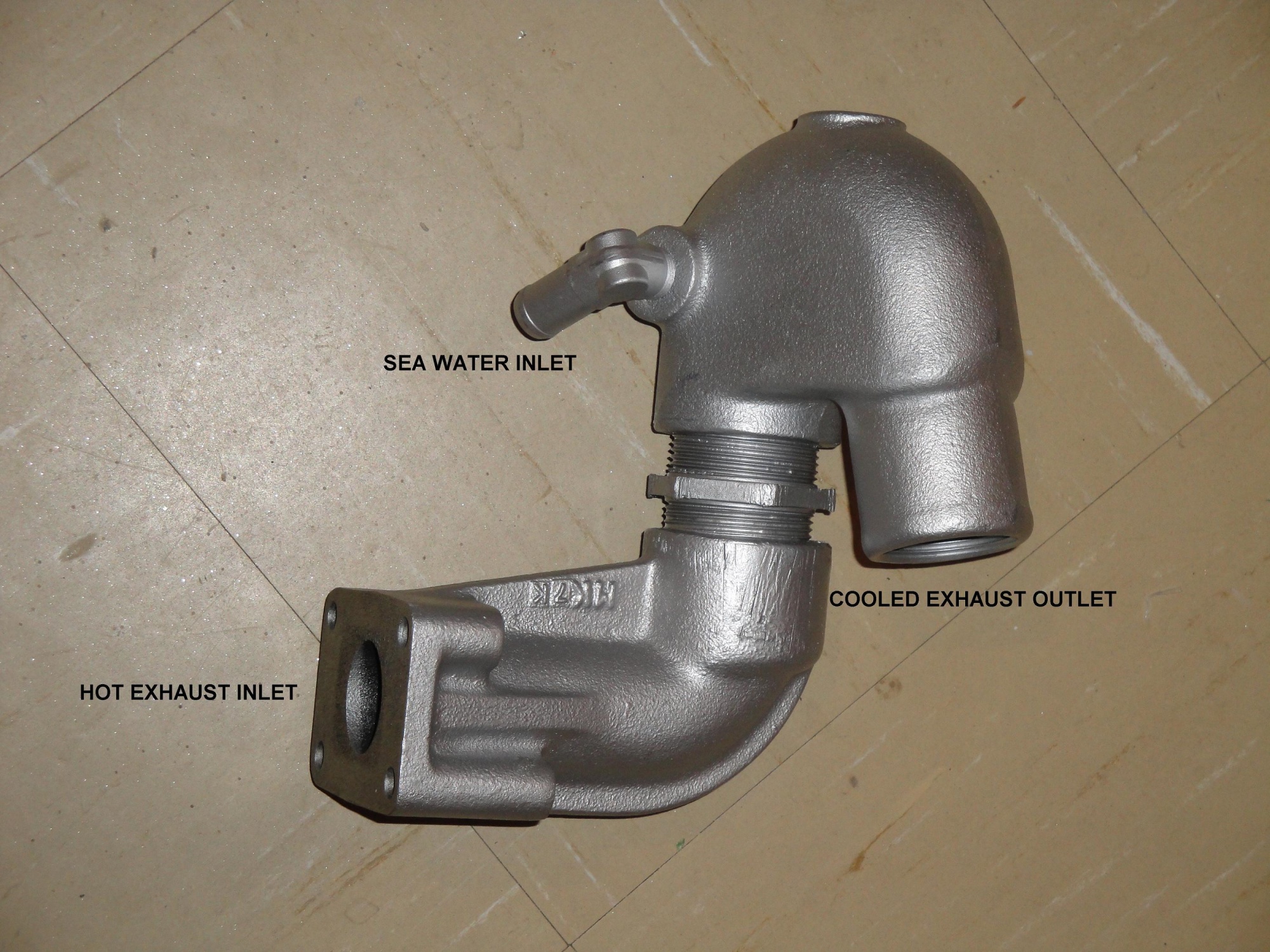

Trust me: if you buy the HDI mixing elbow, buy the whole deal: the mixing elbow, the manifold, and the threaded pipe in between. Ask me how I know:
My old parts looked almost new, and there was no way I was getting them apart. I used a torch, PB blaster, and a 5 foot breaker bar, and all it got me was a broken vice*. Just buy the whole thing and be happy you're not paying a mechanic.
