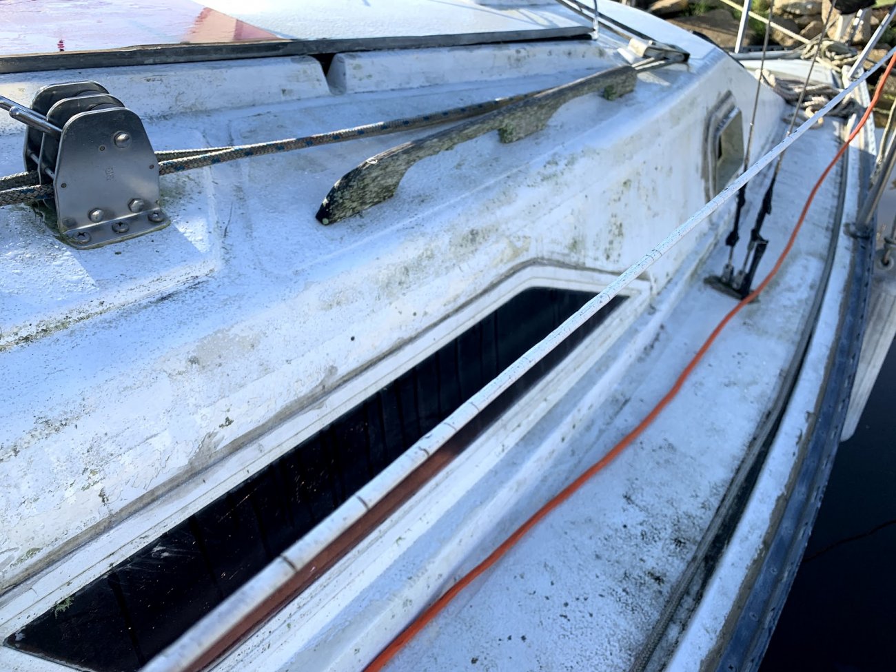

I recently took on this project boat and am slowly making progress on renovations.
While cleaning up the deck for painting, I noticed that there was a railing or something mounted to the sides of the cabin at some point. I have a picture attached showing where the rail was clearly mounted. When I do a google image search, I can see where the part is mounted, but I am not able to zoom enough to identify the part and cannot find it anywhere online.
If anyone has a similar boat, can you please post a closeup of this item as well as details?

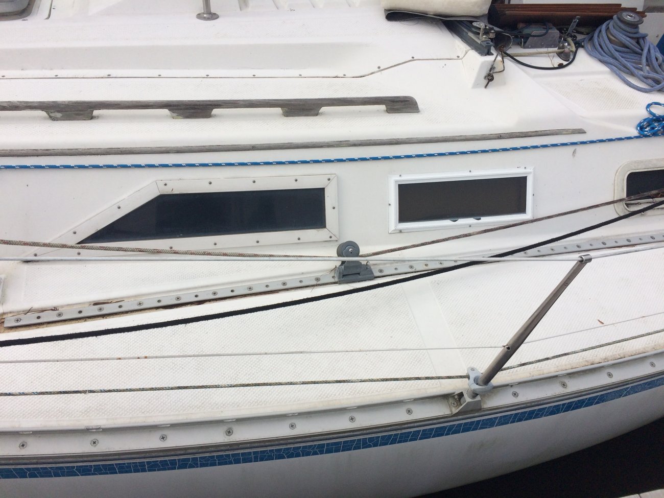

The teak "eyebrow" trim piece right above the ports.. You can see the shadow of where it used to be.. It is a piece of teak originally that was about a half inch wide and maybe three-eights thick with an oval cross section, and kinda pointed on the ends.. the screw holes were plugged. This would have to be a DIY part.. Many folks remove the eyebrow and patch the screw holes.. some folks make new ones.. Picture is of the one on my 34, right above the fixed port..
