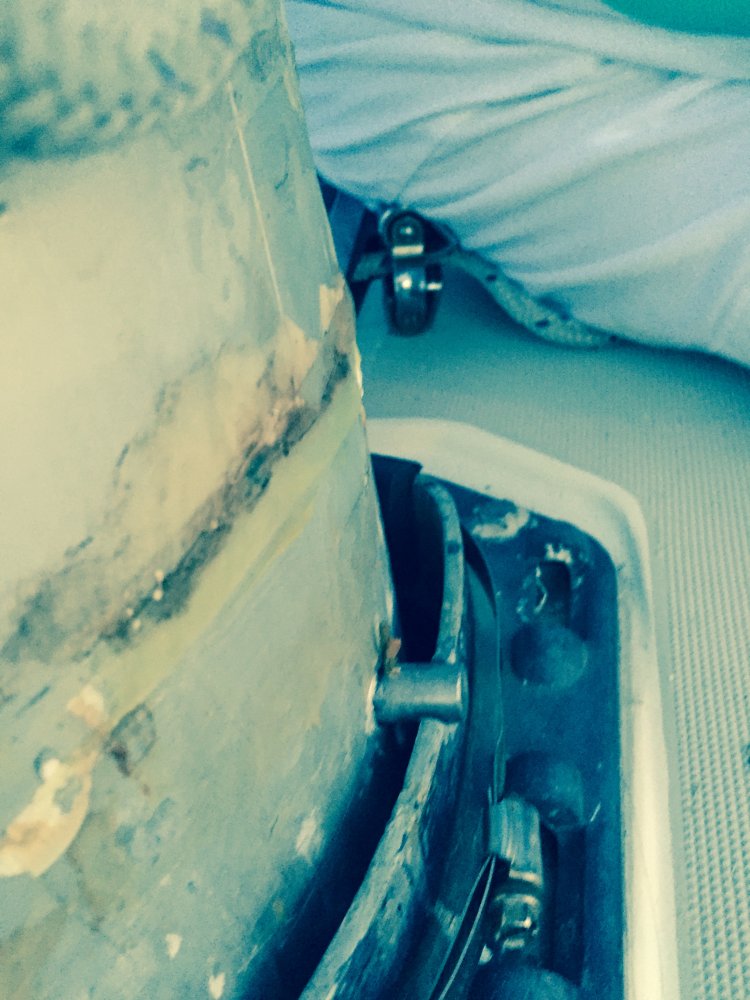

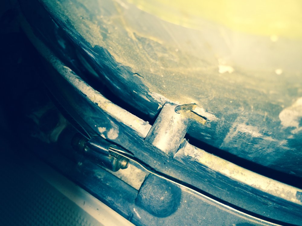

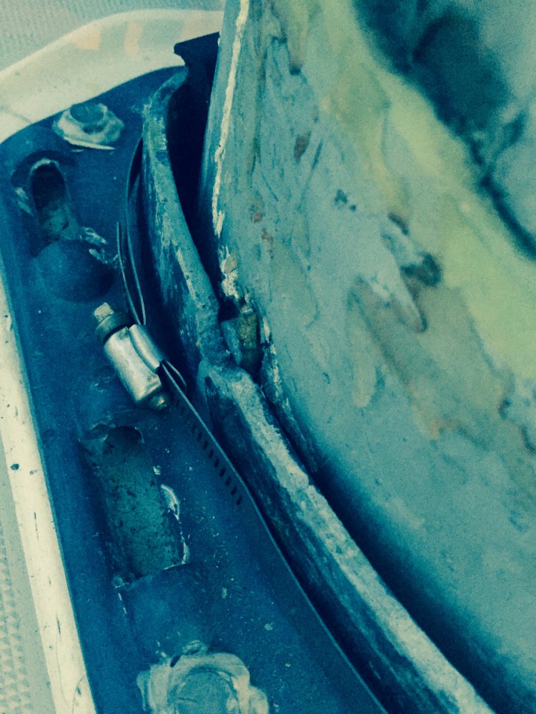

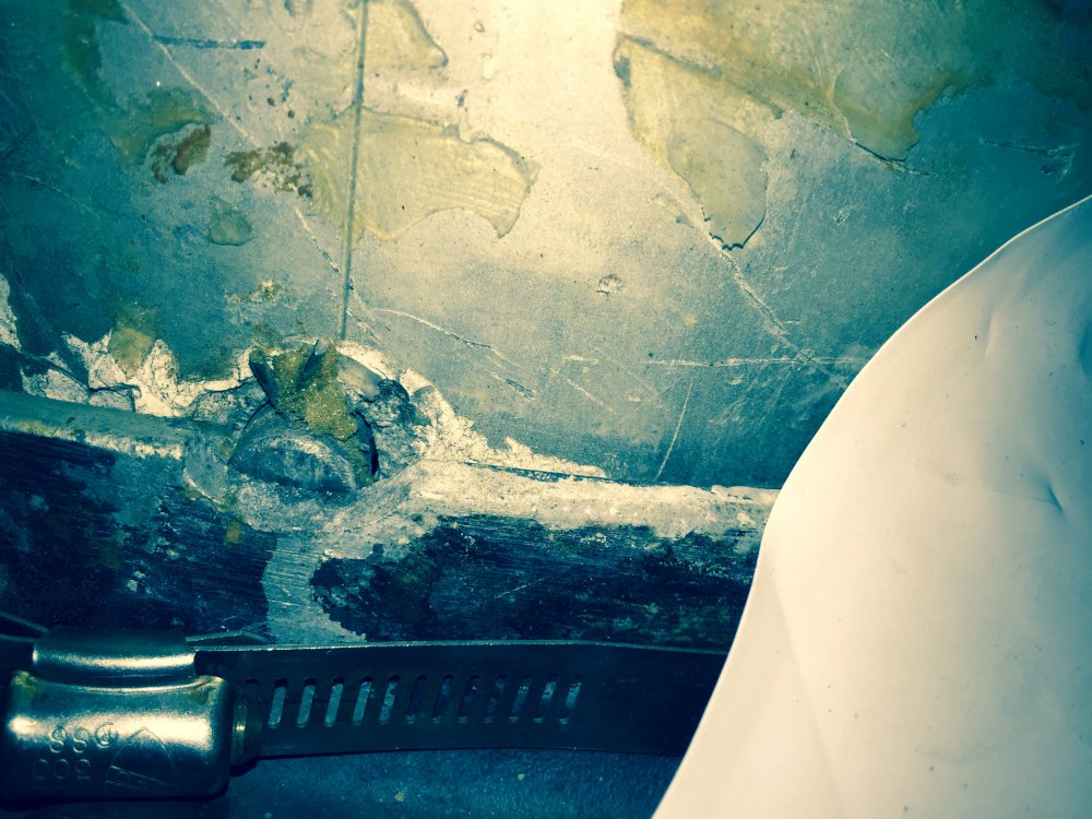

njlarry, after owning FH for a couple of years, the admiral suggested that we replace our mast boot. Here are photos of what we found..... Admiral panicked when she saw that the pin had apparently sheared off, immediately called the PO, who told her not to worry and that it had probably been that way for a while and posed no immediate danger, and to just replace the pin after the sea sun once the mast was unstepped. So we continued to sail and enjoyed our sea sun. the following spring we found 1/2" s.s. rod, had her son cut it to length, drill new holes for cotter pins, and voile... we were like new!!!!
Measure the height from from your mast step plate to the cradle on your mast deck plate that the pin would sit in, if it has one. Carefully drill through your mast, avoiding any wires and that's it.....

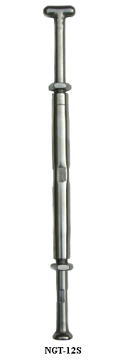

It turns out that there are "Deck Tie Down Turnbuckles" available from RigRite (hold on to your wallet) that insert into these notches. The turnbuckles (also available from RigRite) look like this:
