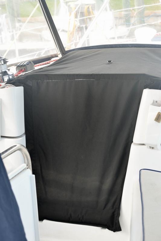

As far as the companionway goes, we have a dodger so never get any water on it while sailing. When we haul the boat for hurricane season and so all the canvas comes off. I made a companionway cover to keep the sun off the wood and plexi as well as keep it dry in a storm. We now often use it in a marina for privacy down below.
I found while washing the boat we can get water coming in the companionway if the plexi is pulled all the way aft. I push it forward a half inch so the lock just lines up. Then no leak. It is not an issue in storage with the Sunbrella cover. The D ring on the cover tents it up with a line to the dodger frame while in storage.

Thanks Bob! Do you use a weights to keep the Sunbrella cover on? After reading the link you sent me I will see if the water is possibly coming from the handrails or other areas around the windshield before I look to start over. The acrylic is new so I hope it will come back out without breaking, I will certainly use the fishing line trick and rebed with Dow sealant and spacers etc. Still interested to know if I could replace with opening hatches?

Ron, the cover has 3 snaps down each side and a couple across the top. The sides were made a little over size to overlap. The bottom I sewed a sleeve in it to accept a "sausage" made with sand, maybe 3 lbs. it keeps the fabric tight. We will often leave to top two hatch boards out in a marina to block the view inside the boat but still allow a bit of air flow. It also makes it easier to exit the boat only needing to remove the bottom hatch board. (Sailrite has Sunbrella on sale right now !).
