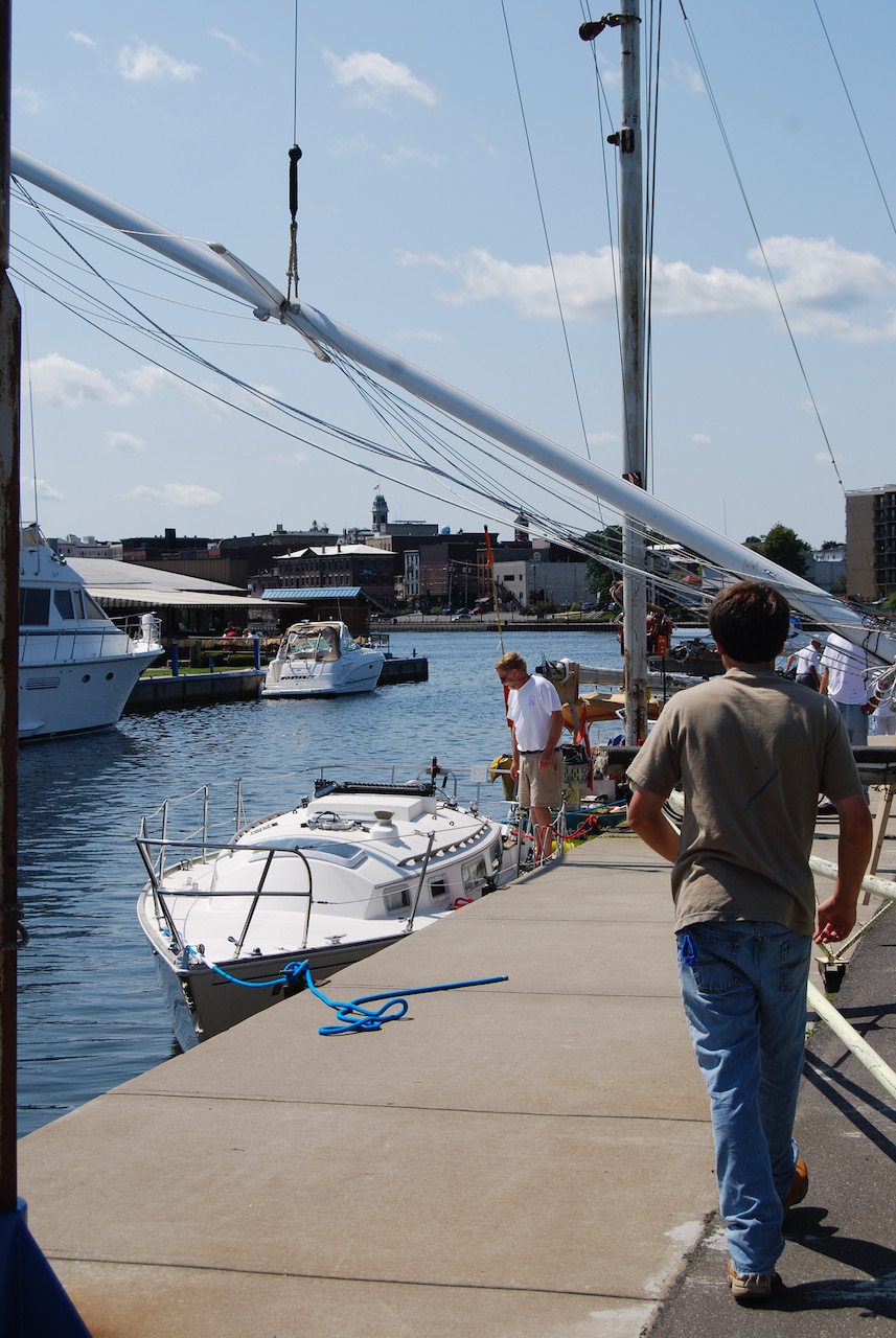

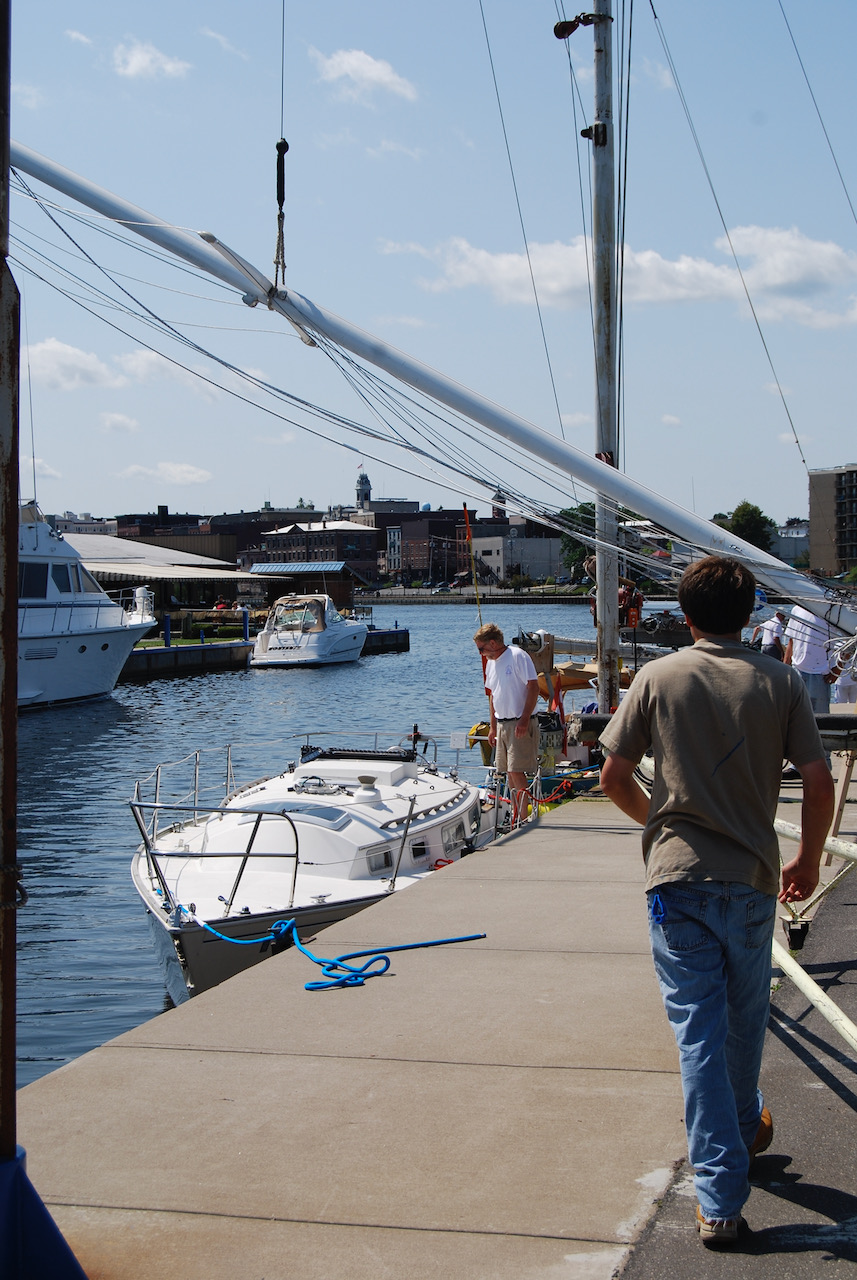

The gin pole we used is essentially a small fixed crane with an arm, not a boat based gin pole. Here's the only photo I have, it shows the lower part of the pole. The boat is a Sabre 30 with a deck stepped mast. We used the same gin pole for my Tanzer 22. From start to finish stepping the mast takes about 20 minutes.
