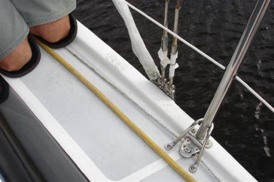

I have mid ship cleats on my 29.5
Hi, I did not do it myself they came with the boat. I had to tighten them up and add a little sealant last summer. I was able to access the nuts from the inside without taking anything apart. It seems like a easy thing to drill and have large washers or a SS back plate made up for reinforcement. My boat is on the hard with lots of snow on it… I may not have access to it to take picture for you on the location and back plate but if you really need and want them, I could do it later for you as soon as the boat yard is accessible, 30 to 45 days.... Mario

How about a cleat mounted on your sail track
It mounts on your T-track, and can lock into any position where there is a hole on the track. Since the track already has enough backing support for your jib, it should be able to provide enough support for your midship cleat.
