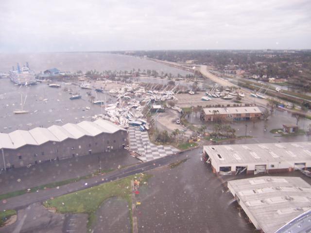

How bad an idea is this?
The TS warning got me to thinking (and after looking at post Katrina pictures of a bunch of really nice sailboats all stacked in a neat pile in one corner of the marina), what would be wrong with taking a sailboat out into the middle of the Lake and setting a couple of anchors and letting it ride out the storm (with no one on board)? I can image the CG may have issues with it, but is this a viable strategy for giving a boat a fighting chance to survive a bad storm?

Ohhhhh.. not a good idea because of the waves, Ken.. The lake is only about 12-16 feet deep and the waves can get REALLY big.. If the boat didn’t swamp, the lines would most likely chafe through.. Best is to get some wind shelter and a place where there is not much fetch for the waves to build.. For Katrina, a friend of mine who had a 53 foot Hatteras in South Shore Harbor, took her across the lake and tied up in the trees in the Tickfaw River. Made it just fine.. That boat is a sedan and has a lot of sail area because of the cabin and flying bridge. Back in ’78 (?) for Hurricane Frederick in Mobile, my brother took his O’Day 25 up the Dog River and anchored with two anchors and a lot of chafe gear in the middle of a narrow section of river.. Made it with no damage at all, unlike his house.. Took us about 3 hours of winching to retrieve the anchors.. they’d been well set by the storm! For Katrina my boat was in a marina in Mandeville, on Bayou Castine. Good wind shelter and no waves .. only problem was rising water .. It is a challenge to secure a boat in a slip such that it can take an additional 6-8 feet of water.. I got a couple of chips in the gel coat where she leaned on the pilings, and a broken life line from it hanging on top of an 8’ piling as the water came down.. I have seen boats scuttled in the slip at Corpus Christi back in the 70’s to avoid damage.. They’d removed all cushions, and the outboard engines and whatever else could be damaged by water..
Best to get her out of the water and secured in a place with some wind shelter.. I have seen pictures of places in the islands that have a trench for keels; they set the boats on the trench and guy off the mast to successfully secure them from the wind.. but must be high enough to be out of the flood surge.
