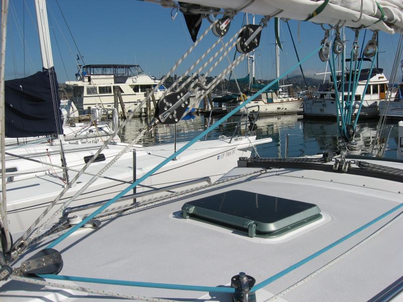

37c owners with travelers on the cabin top. How does your main sheet attach to the boom? Single point like the bridge deck traveler, or 3 single blocks spread fore and aft?

Hey Bill, going to move yours? The H37C Picture post has a few closeups. I see in the pictures that there are three attachment points on the boom. If I made that change I know that is how I would do it. Really need to spread the load.

Yes, gonna move it to the cabin top. For this week will be single point mount using existing main sheet tackle. Soon after that will have old pin stop traveler free for shipping costs.

Bought Garhauer, I like their stuff. Got the Catalina version with both traveler controls coming off the port side. Put towers on yesterday, plan to mount on cabin top tomorrow to determine line leads, notches need in dodger. Probably going to bow to crowd thinking and put 3 single blocks on boom,even though I don' believe this is necessary.

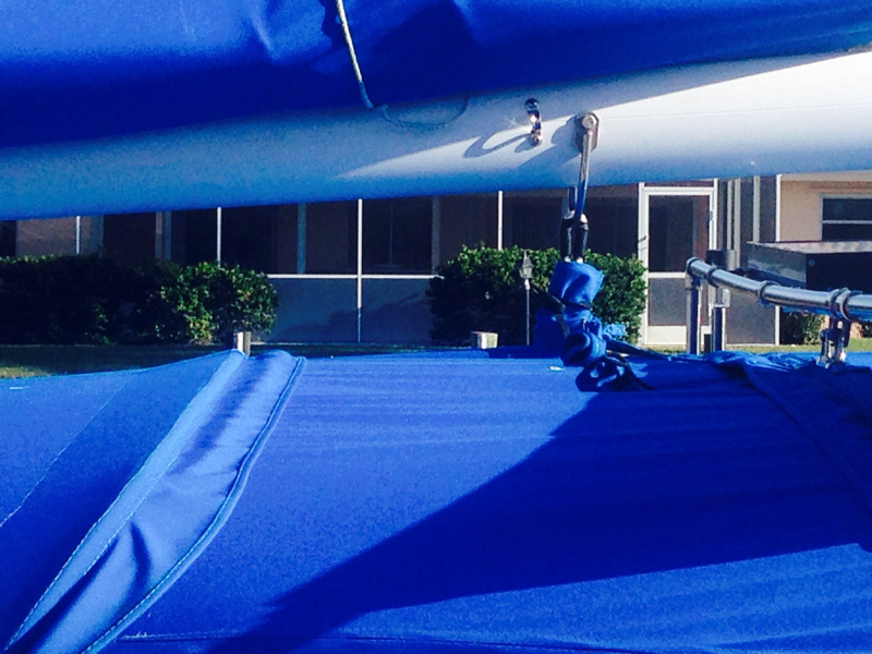

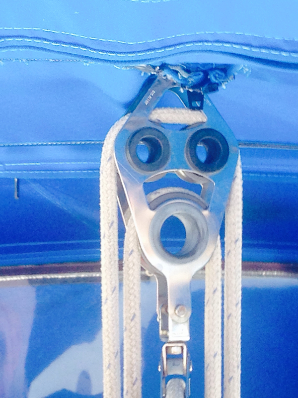

Really Spread Out
The stress loads to the boom are really spread out with this rig! (see pic attached.) Good enough that a not-paying-attention-while-trying-to-take-a-picture-of-a-passing-Oracle-AC-72 accidental jibe in 25 kts winds didn't cause damage to the boom. Although the force was significant enough to shatter the delron bearings in a couple of the mainsheet blocks.
