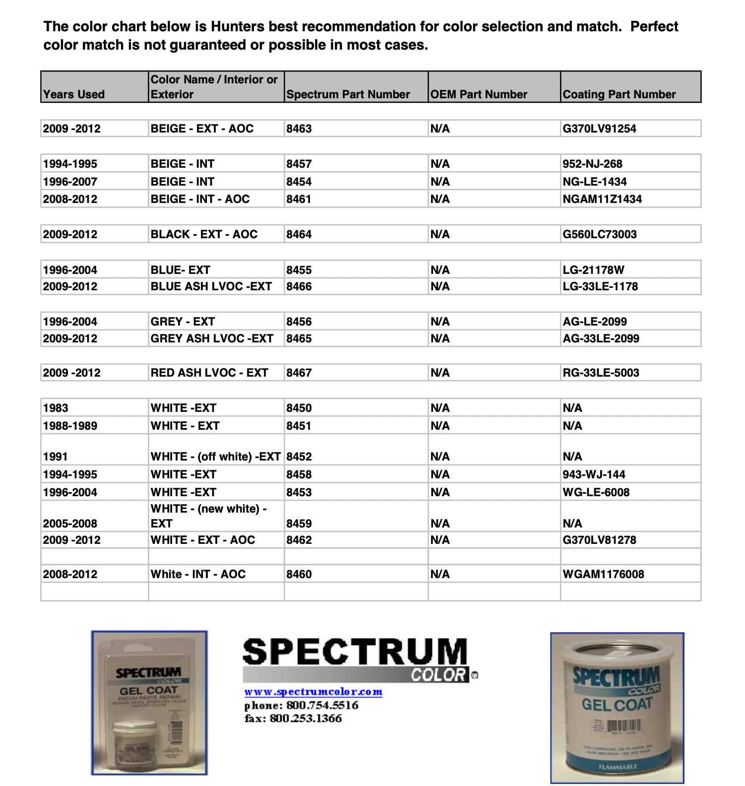

I took the time to research the Hunter website and found the codes, but it also states there clearly “color matching is not possible in most cases”.
So, roll the dice with that last last known product code, or hire someone to mix up a custom matched mini-batch? (I would take a rear seat hatch off, buff it, and have them match that, in their shop….that be the current plan).

I have done numerous minor gel coat touchups on our 1999 H-310 using pure white waxed gel coat. They are completely invisible when finished as there appears to be no fading of the factory white gel coat due to UV.
See post #3 and #7 :

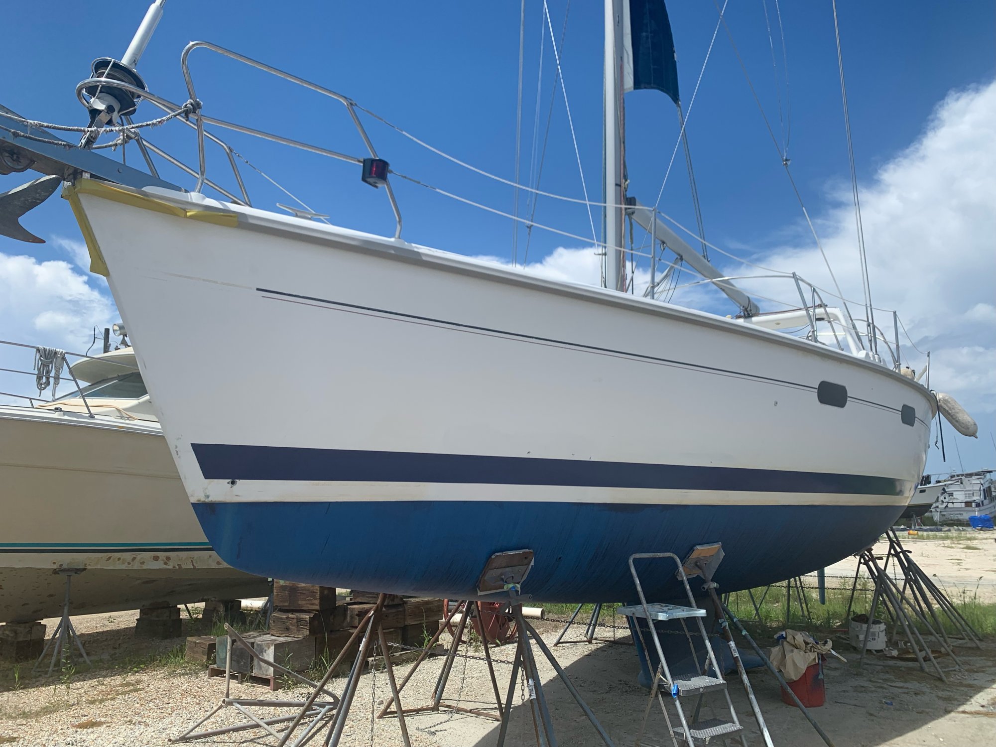

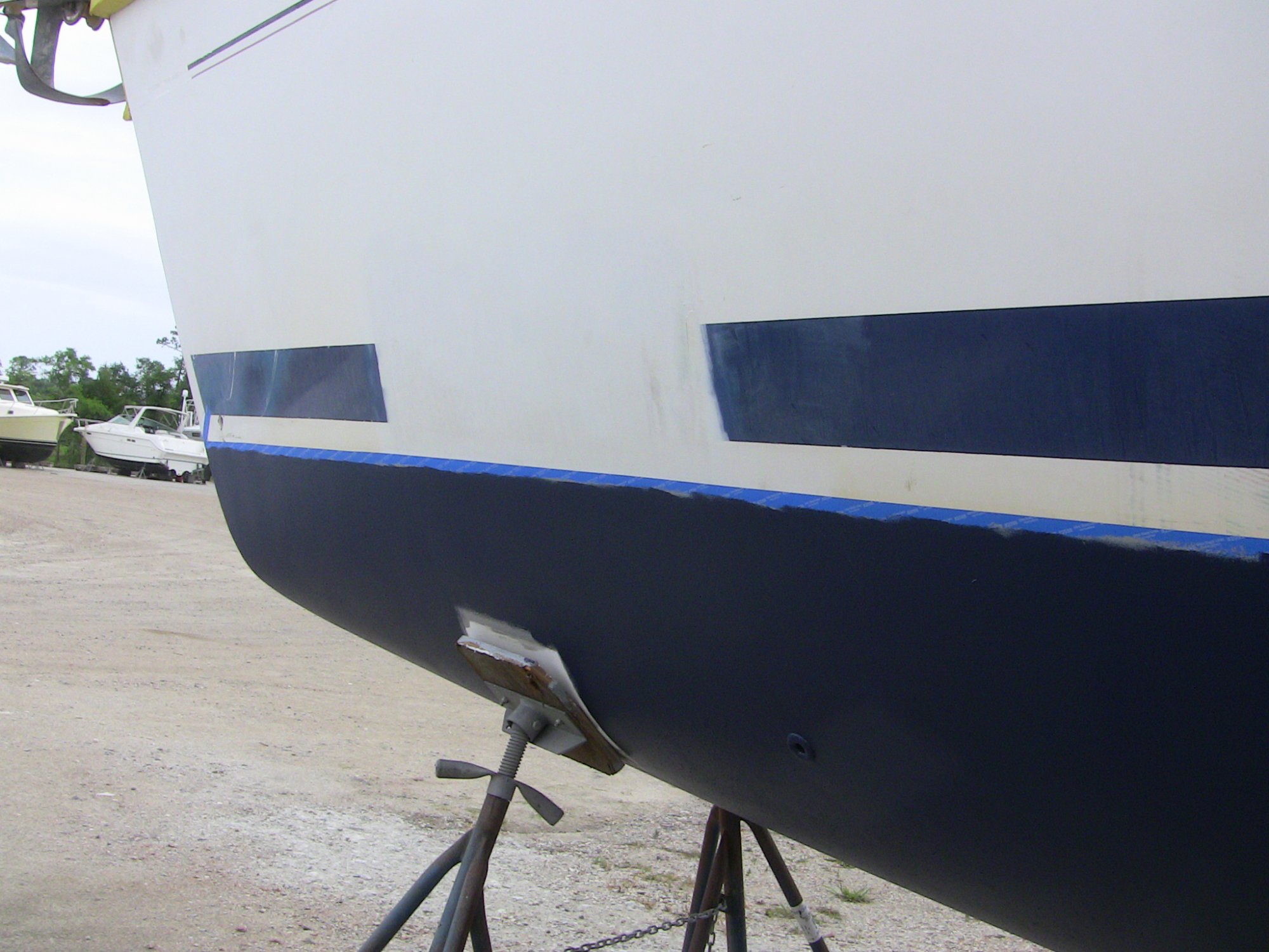

My White and Blue were a perfect match. 1998 boat
Blue before..
Blue After..
