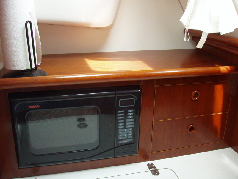

Greetings
I went to my boat yesterday and noticed that the microwave is not lit up and appears w/o power. Did not have time to play with it but I did check AC and its on.
I was wondering how it is slid in and is it typically fasten some how? Also I'm sure it's plugged in behind the unit but not sure. I was also wondering if it could be a tripped gfi outlet.
I have a 331.
Thanks
Craig

On my 331, microwave only gets power if the Outlets breaker on the shorepower panel is on.

My 5c would be on the GFI, I had non functioning microwave and resetting the GFI on the breaker closest to the MW fixed it.

On my 2009 B37, there were 2 screws underneath the wooden platform it sits on, and by unscrewing them, was able to slide the microwave out. It was plugged into a wall outlet inside the space.

Checked it out and gfi was fine. It is somehow held in to some plastic pockets perhaps screwed in from the bottom as was mentioned. The is a vent in the locker but to get under it I need to go though an access panel. I know it's not too critical but I'd like to be able to use it on occasion. I'll try calling Beneteau next if I can figure it out.
