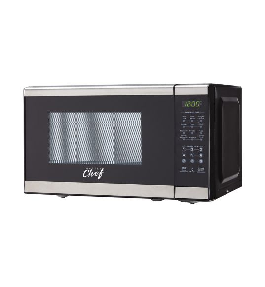

http://forums.catalina.sailboatowners.com/attachment.php?attachmentid=88454&stc=1&d=1432735823
I bought this micro wave at Canadian Tire in Toronto. It fit perfectly with out any fiddling with it.
* Master Chef 0.7. cu.ft. Microwave Oven features 6 auto cooking/one touch menu for frozen dinners, reheating, beverage, potato, popcorn and pizza
* Features digital timer, digital clock, removable glass turntable, and push button door style
* Stylish black and stainless steel finish add to any kitchen décor
0.7 cu.ft capacity
* 700 watts
This is my second season and it works well.
Cheers
2 OLD PIRATES:D
OH I forgot it was $69 Canadian + Tax
