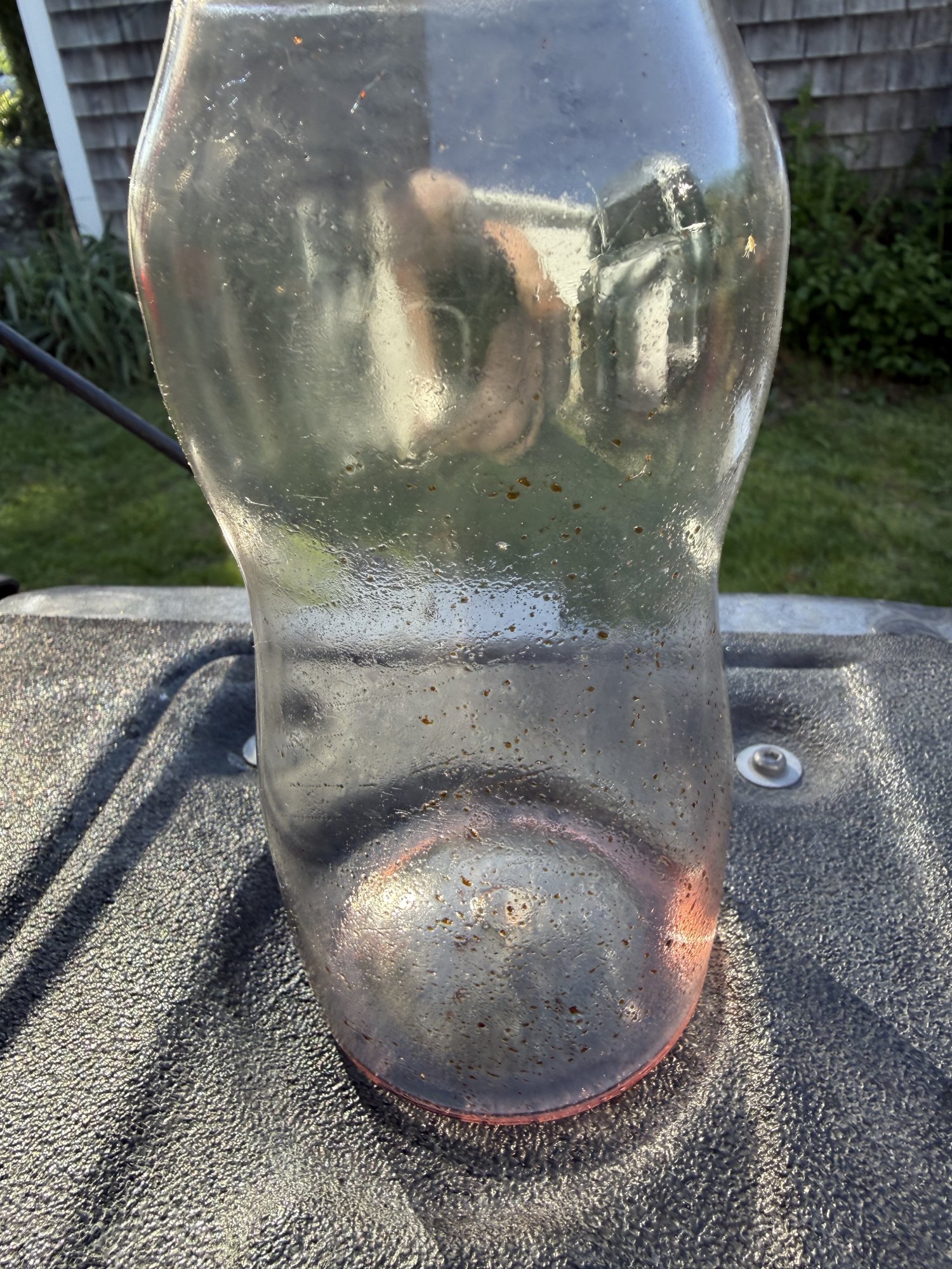

I am new to diesel engines (last boat was an atomic 4). This is my 2nd year with the M25XPB in a catalina 28. Last year was just a feeling out the boat year because it sat for a couple of years in the owners yard. Today I replaced both filters and was happy the quart or so of fuel from the old filters that looked clean until I recycled it and the boatyard owner said I had microbes. The empty jar had a bunch stuck to the inside after I dumped the old fuel. By a bunch I mean every inch or so in the empty jar was a little blob (about (2mm in size). The engine ran about 14 hours last season.
Last year I treated the old fuel with Power Service diesel treatment both the white and the grey. The existing fuel was a couple of years old when I bought the boat. I bought some Biobor to treat the diesel going forward.
Should I be worried? Or just run the boat with the treated fuel? Seems to run fine but I haven't tested it for a long time in rough seas.
Size wise - more like coffee grinds.

This was the fuel poured out of the old filters? If so, then I'd expect to see some crud in it. That's the entire point of a filter. If this is the amount that was filtered over many hours of operation, then it isn't a lot.
However, any crud is still crud, and it had to come from the tank. Is there a way to visually look inside the tank? That would tell you a lot - particularly if you can get most of the fuel out before hand.

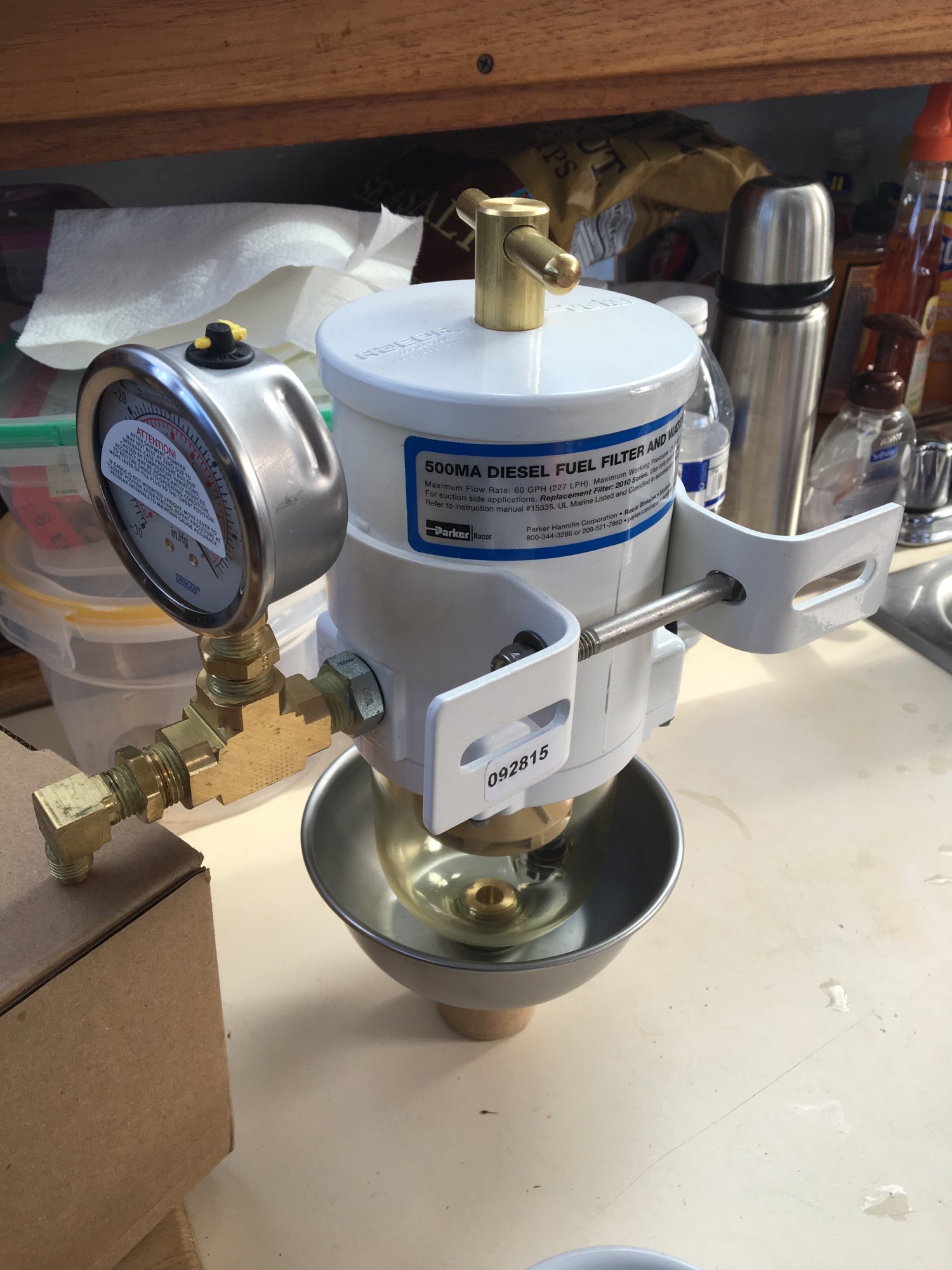

On my boat, here is what the fuel filter looked like. It is a Racor 500ma filter housing.
I use a Racor 2010PM 30 micron filter.

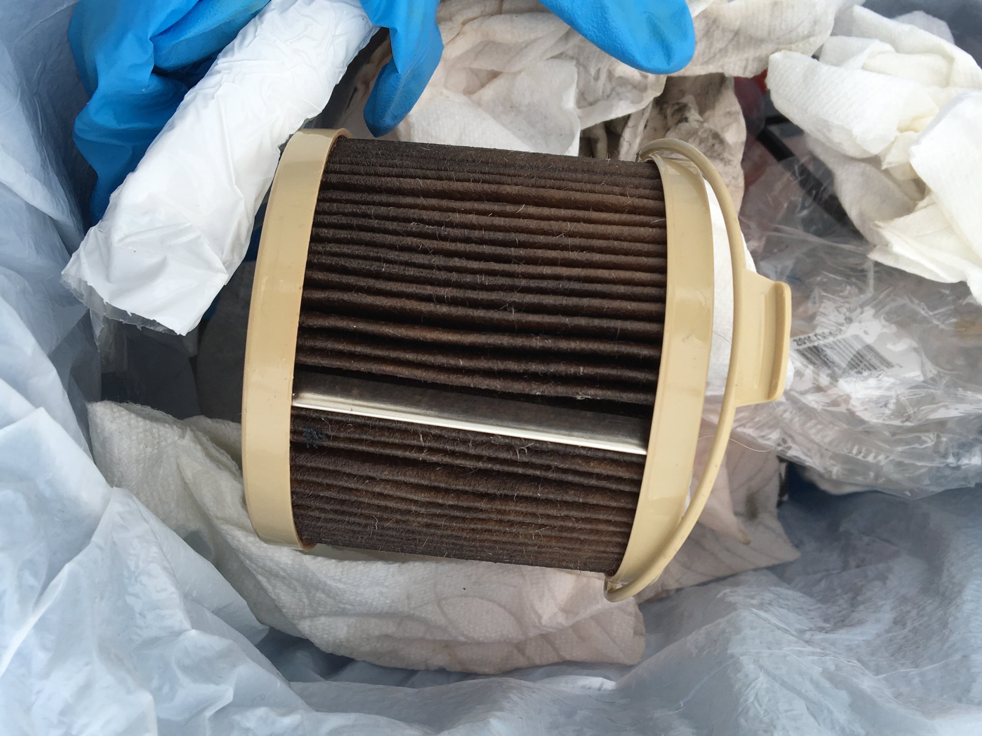

When they get dirty, the guage on the filter housing moves into the red, indicating the filter is getting clogged. Here is a dirty filter.
Time to change the filter. If you do not change the filter, the engine will stop. On my boat, this means a belabored process of bleeding the fuel lines after you change the filter. I got pretty good at recognizing the engine was in trouble. I learned to make a change in about 7 minutes. Stopping before the engine died meant I did not have to bleed the engine.

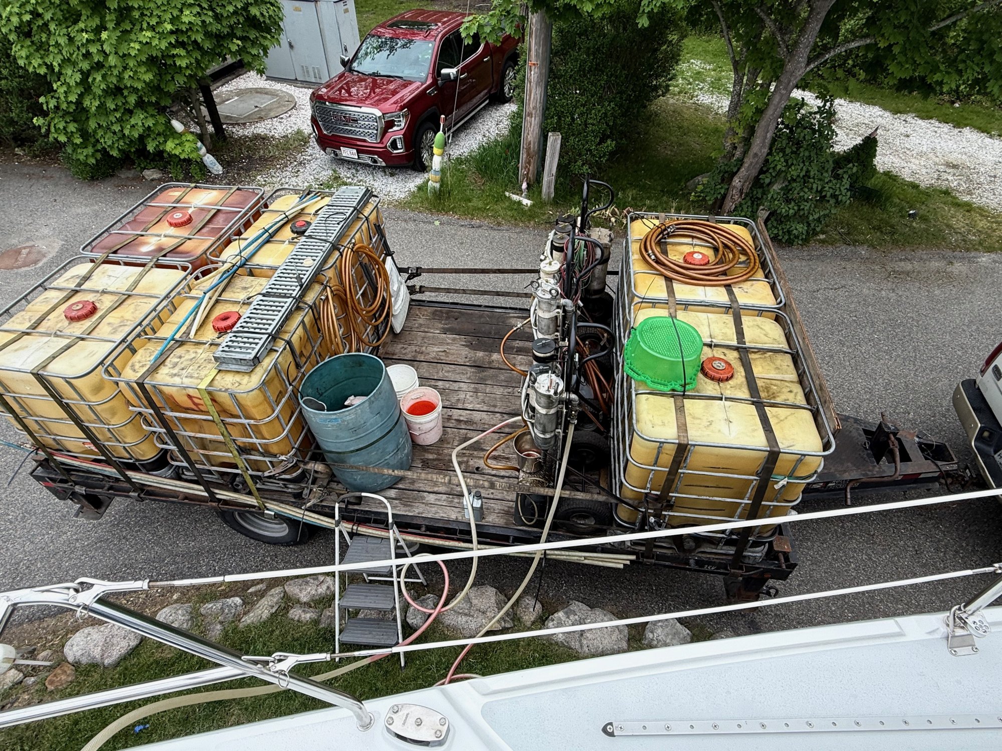

Just hired USAFuelService to polish and clean the fuel. They come to you. This will make me feel more comfortable running the engine this Summer. Price $525.

final price except $49 for a bottle of their special additive.
