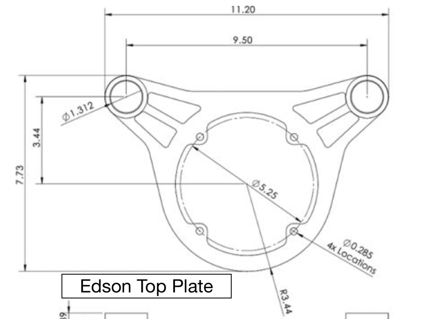

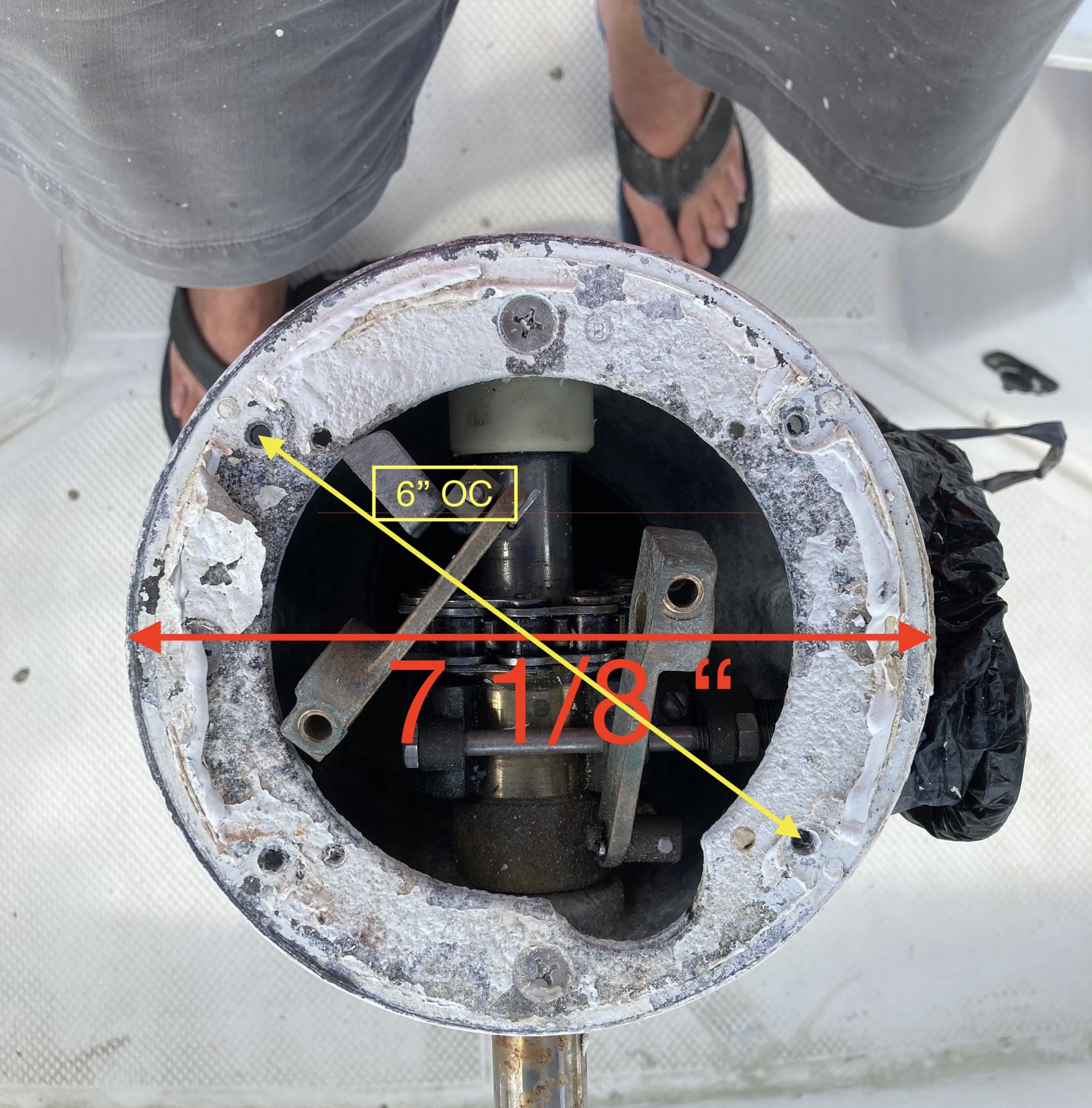

Before I fashion my own top plate from Starboard, thought I would ask one more time if anyone has found an after-market top plate that fits the old Merriman YS pedestals on H34 (see photos). I'm replacing pedestal guard with 1.125 tubing at 9.5" OC.
