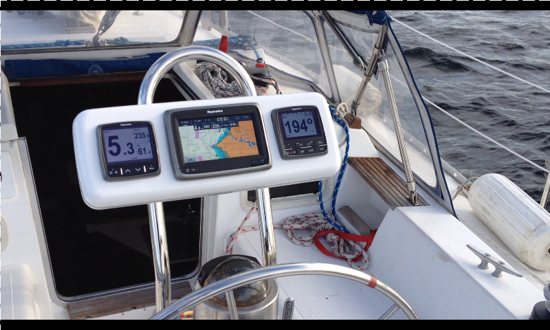

Look on the base of the pedestal, that's where mine says Merriman. Is it possible that someone used an Edson yoke? I read somewhere that the standard Merriman pedestal guard installation was a 12" center model. My H34 came with a 9-1/2" center guard that was mounted on the pedestal base but there are old holes on 12" centers forward of the base on the cockpit sole. My guess was someone switched it out at some point. My yoke looks to be a piece of aluminum that was fabricated to fit.
I recently went through the same exercise to add electronics at the helm. I ended up getting a new 1-1/4" guard because I read that some connectors much less all the wires wouldn't fit in the 1" size. I simply put a grinder on a drill and reamed out the holes in the yoke and it all worked out great. The new guard also allowed me to raise the electronics a little further away from the binnacle compass than would have been possible with the old guard.

Very nice picture; thank you.
I do not have any evidence of conversion, and if I go forward off the base, it won't align with the yoke. The base measures 12" wide and is elevated fiberglass, so if I go to 12+ inches, there will be fiberglass remodeling involved. I plan to mount only a chartplotter (other instruments on the cabin wall). I'm afraid if I widen the yoke holes it may break in the future when it has to be removed (was a bear this time).

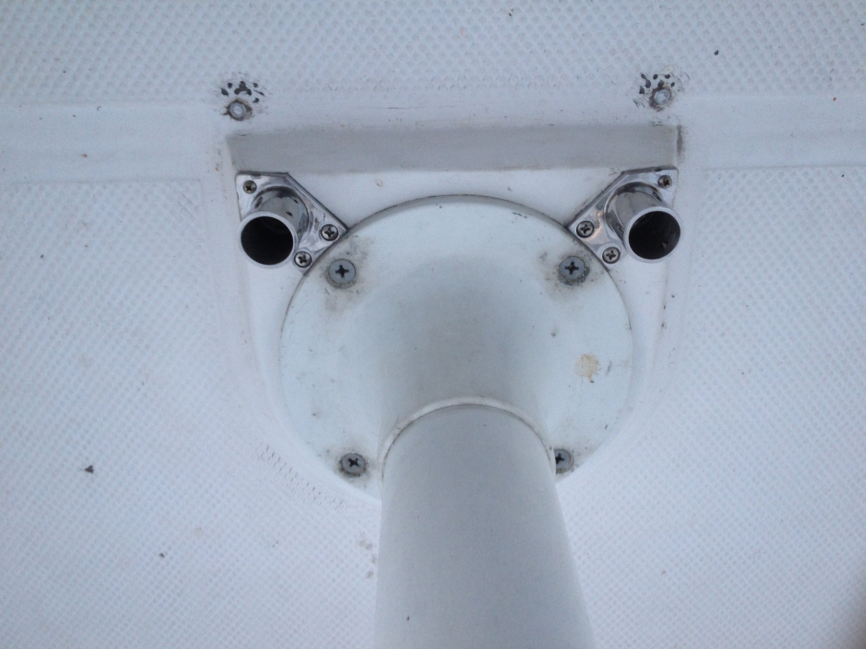

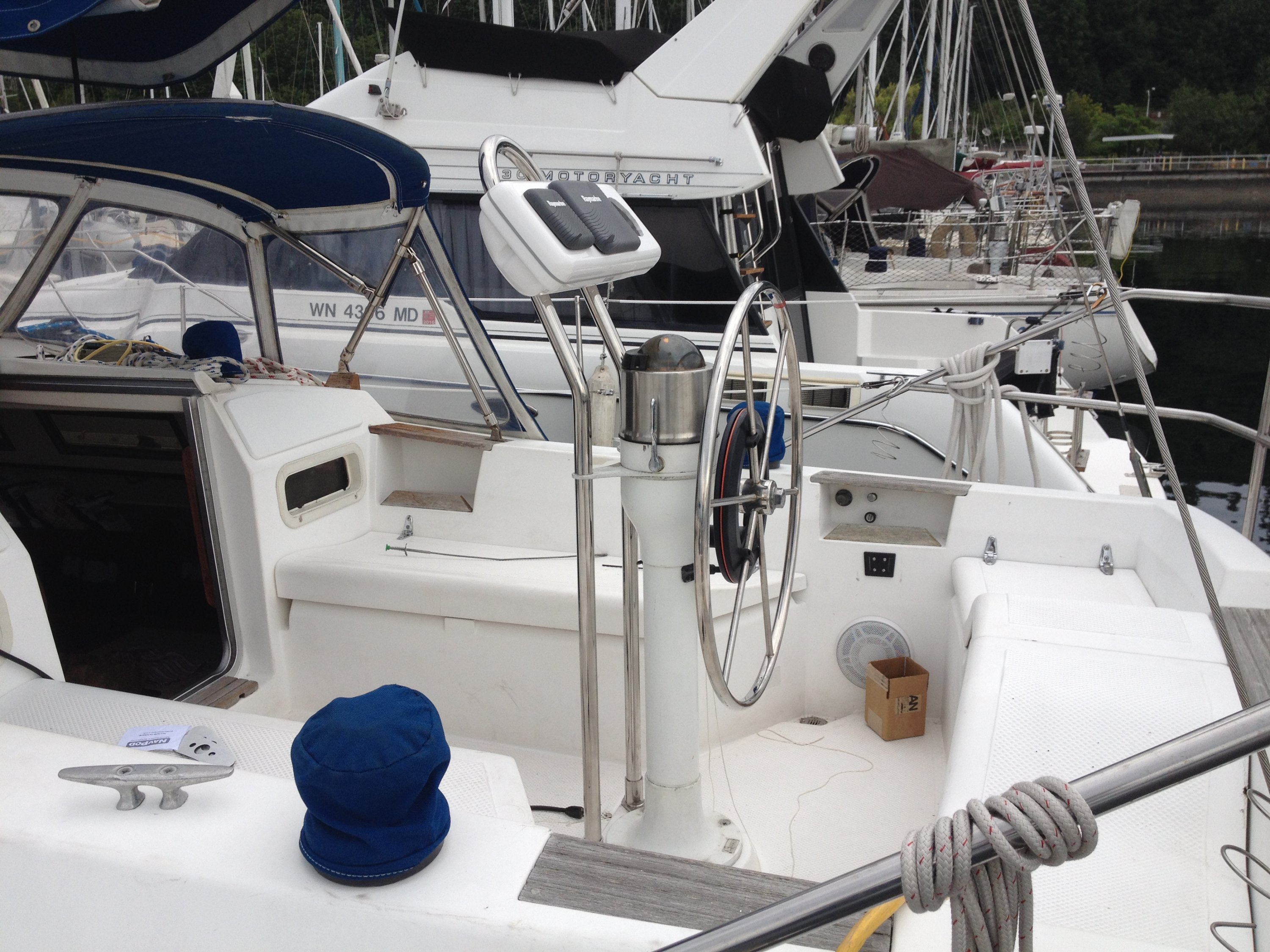

Yes, I agree. 12" centers will not fit on the pedestal. I have what appears to be an old installation that is forward of the pedestal. I currently have the 9-1/2" centers mounted on the pedestal. My yoke was easy to ream out because it was simply 1/4" aluminum plate. You can see it in this photo sort of sandwiched between the pedestal base and the control head.
The larger diameter guard comes with a base that has flanges. It was a challenge to contain these flanges on the pedestal, I decided to angle them as the only solution that allowed 2 screws per base. Found a photo of the install, don't know why it comes in upside down. You can also see the bolts plugging holes that I think used to be the 12" center installation.

Thanks for the pics. My pedestal does not have the name at the bottom like yours does. I like your guard sockets. My yoke is cast aluminum and much thicker than yours. Does your local company make dodger frames to ship?
