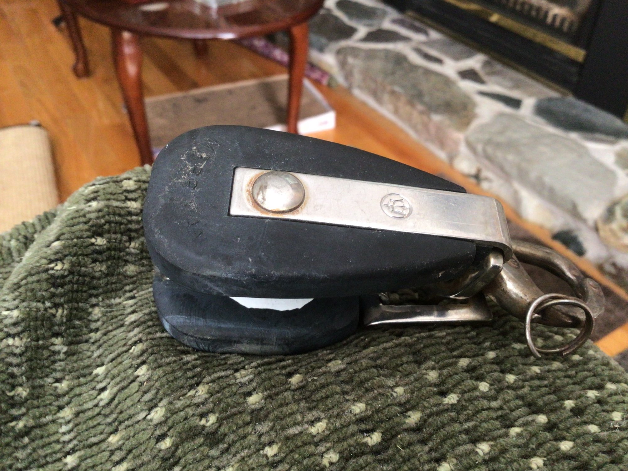

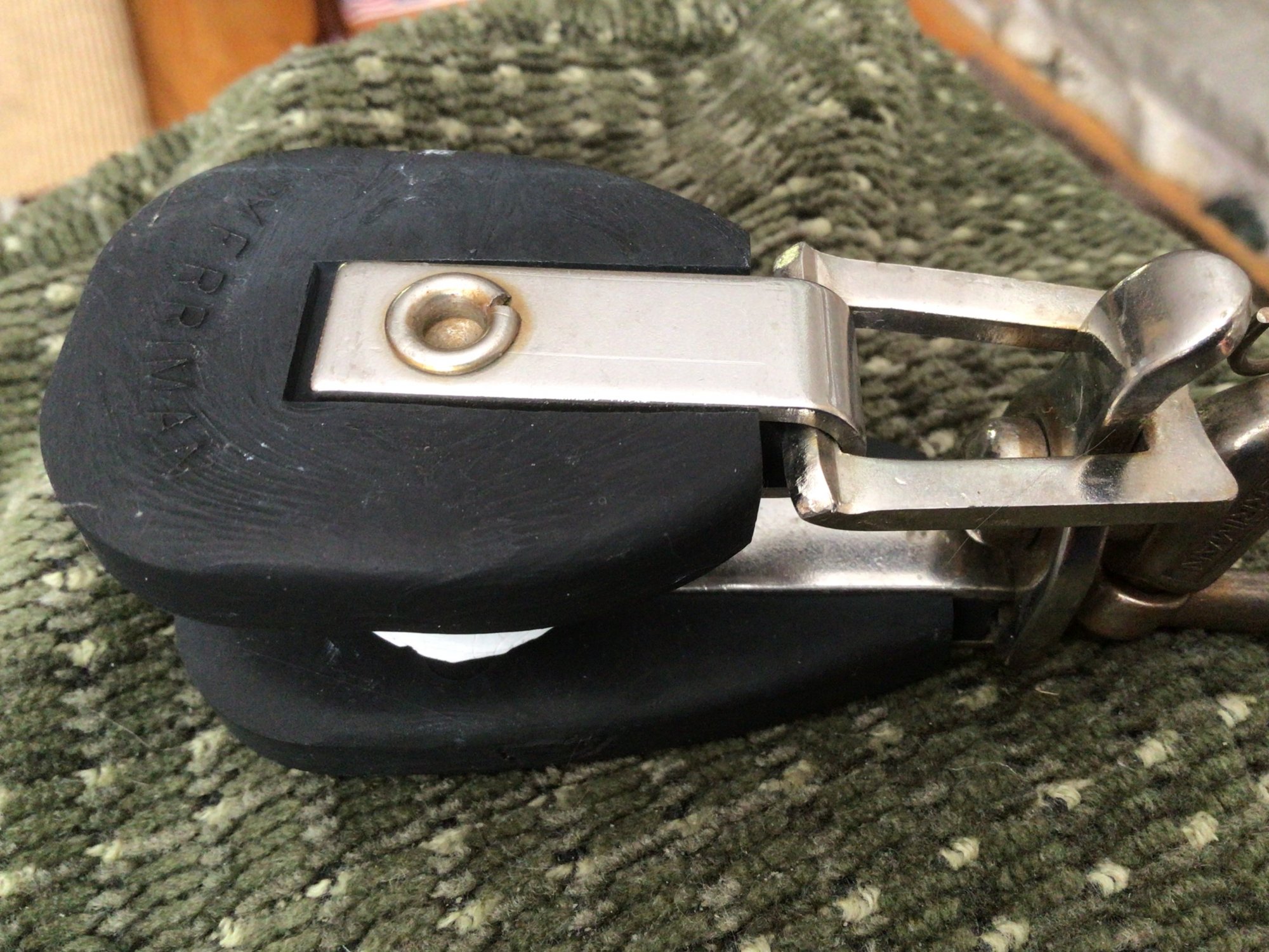

G George Jarvis . Sep 4, 2021 18 Niagara 26 Holyrood Oct 6, 2021 #1 Is it possible to replace the pulley on a Merriman snatch block. See photos. Attachments 1A09446C-E9D6-41E0-8068-0E9E9FC9B284.jpeg 504.1 KB Views: 96 8D012825-80A9-45E2-8133-D232B7F810BD.jpeg 495 KB Views: 91
justsomeguy . Feb 20, 2011 8,062 Island Packet 35 Tucson, AZ/San Carlos, MX Oct 6, 2021 #2 Parts are available. Merriman Snatch Block Parts
G George Jarvis . Sep 4, 2021 18 Niagara 26 Holyrood Oct 6, 2021 #3 How would one get the block apart to replace the sheave? Likes: sail sfbay
justsomeguy . Feb 20, 2011 8,062 Island Packet 35 Tucson, AZ/San Carlos, MX Oct 6, 2021 #4 George Jarvis said: How would one get the block apart to replace the sheave? Click to expand Drill the rivet. A bit of cutting fluid and slow rpms.
