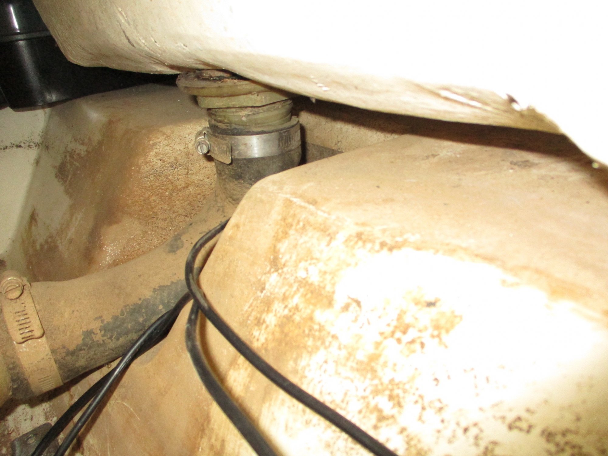

I took this photo of mine (Merit 22) by holding my camera down through the lazaret. a more flexible fellow than me may be able to actually replace the hose via the laz also, or perhaps a skinny fellow could wiggle back there via one of the torpedo tubes. anyway... it sounds like someone has replaced your tube with a piece of straight hose (access port you describe is not an oem item), which obviously won't make the bend required. I would stop by an auto parts store and pick up a 90* molded radiator hose with the proper dimensions. remove your clamps and slice the hose over the fittings with a razor knife to remove the old hose and take it with you for a reference.

Thanks Russ. But my Merit doesn't have the channel under the cockpit drain fitting like yours. My boat was made in '84. That pan or whatever one calls that structure is lower than shown in your picture and is solid all the way across the boat. There is about one inch of clearance between it and the end of the drain fitting.
Tomorrow I'll take some photos so you can see exactly what my problem is.
