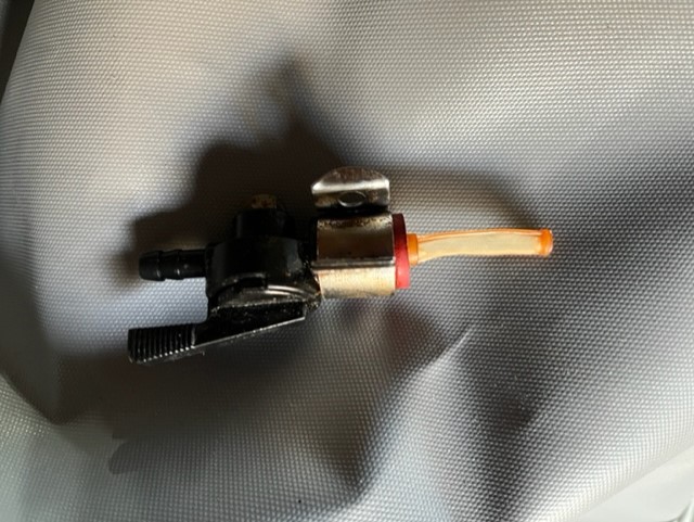

I have just cleaned the tank. I blew out the carb and changed the fuel line. When I back flowed the fuel valve with cleaner very little came into the tank. I thought that was odd.
Now I filled the tank and cranked the motor. It ran great for about 15 seconds. I tried again and the same result except it runs less. The longer it sits, the longer it runs. This sounds like classic fuel starvation.
The fuel valve is assembled with a nut. Is there a filter inside the valve? The tube from the valve sticks up about an inch. I assume it has a slot or small holes to stop large contaminants.

On outboards that I have owned with an attached tank, there has always been a screen filter that attaches to the fuel valve and sticks up into the tank.
Remove the valve and disassemble the filter and clean in carb cleaner. If you can't separate the valve from the filter replace the entire unit.
Some outboards have a small in-line filter in addition to the tank screen. I would replace that one as well.

Thanks Rich. That valve is large enough to have an internal filter. I couldn't see the tube in the tank well. I'll try to clean it tonight.

I (think) I am done.
The cap vent was OK. The filter/screen was not. It was nearly opaque. As I sprayed from the nipple the color changed and went nearly transparent with good flow. I reassembled the tank and tried the motor. It ran then quit. This time it did something it has done before. It wouldn't even sputter. I gave the carb another shot of cleaner but no joy. Step 1 is fuel. Step 2 is ignition. I pulled the plug, and it was wet. I found a small engine plug in the toolbox and installed it. It had a nice sound for about 5 minutes and then I was able to drain the bowl. I see a visit to the auto parts store coming.

If you had that much gunk in/on the tank filter I would suspect that there is more in the carb.
Spraying cleaner into the throat of the carb only removes surface deposits. Cleaning the internal carb passages and jets are critical for proper running.
If you also suspect the ignition, then that would be the next area to check. You can get a spark gap tester to put in line with the spark plug for testing the spark quality.
If you still have running problems then I would pull the carb and install a rebuild kit. Spray carb cleaner through all of the internal passages. If you have an ultrasonic cleaner, fill it with carb cleaner and process the carb for 30 minutes.
If you are not using E0 gasoline, get some and use it exclusively. The use of E0 gas will prevent almost all fuel problems.

Thanks Rich and Tom. The thing is that the tank was clean. I soaked it in Seafoamed gasoline just to be sure then chased that with cleaner. The filter was the thing. When I bought this boat it came with the 3.3. The seller had recently put it in the shop for the sale. (I have that invoice.) I think the carb was clean also, but it was cleaned thoroughly from dip-tube to venturi. I blew it out from the mixture screw hole also. I'm guessing the tech didn't take much time with the motor. I run only E0 premix in all of my 2 cycle engines. The others use pickled fuel.
When I tried the motor in October it ran great then quit. I had a backup electric on the boat and got back in with it. I drained all the fuel and set the 3.3 aside. Now, I have two problems, one that is intermittent. The motor ran great with the test plug. I'll get a new plug today and give it a good test tomorrow on the water. I will take an electric for backup.

Thanks Benny. I only run E0 premix. This thing had two problems. A dirty fuel filter and an intermittent spark plug. The filter was easy enough once I got deep into the problem. The plug drove me crazy. The original plug was an NGK BPR6HS-10. Best I can tell this is the correct plug. I couldn't find a replacement. It crosses to an Autolite 4123 which was available.
The big question: I read at NGK that CDI systems will destroy a standard resistor type plug. I don't know what the original was. I don't know what the Autolite is. I couldn't find a non-resistor plug. I have a headache from too much screen time. :banghead: All that being said, I bought a spare plug and keep a plug wrench in the tool kit.
