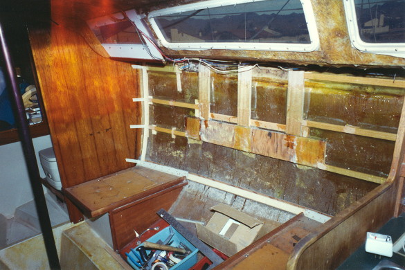

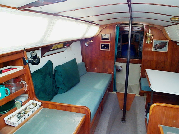

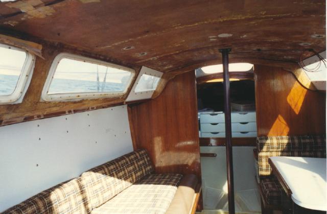

I resurfaced the interior of my 1978 Lancer 28 with Formica. That was 15 years ago, and it still looks great. I like the semi-gloss look and the permanence of the material. And I hid some wiring under it too. The Formica sheets are screwed to wooden strips I glassed onto the hull and overhead. It's can be a big job, but you only have to do it once.
