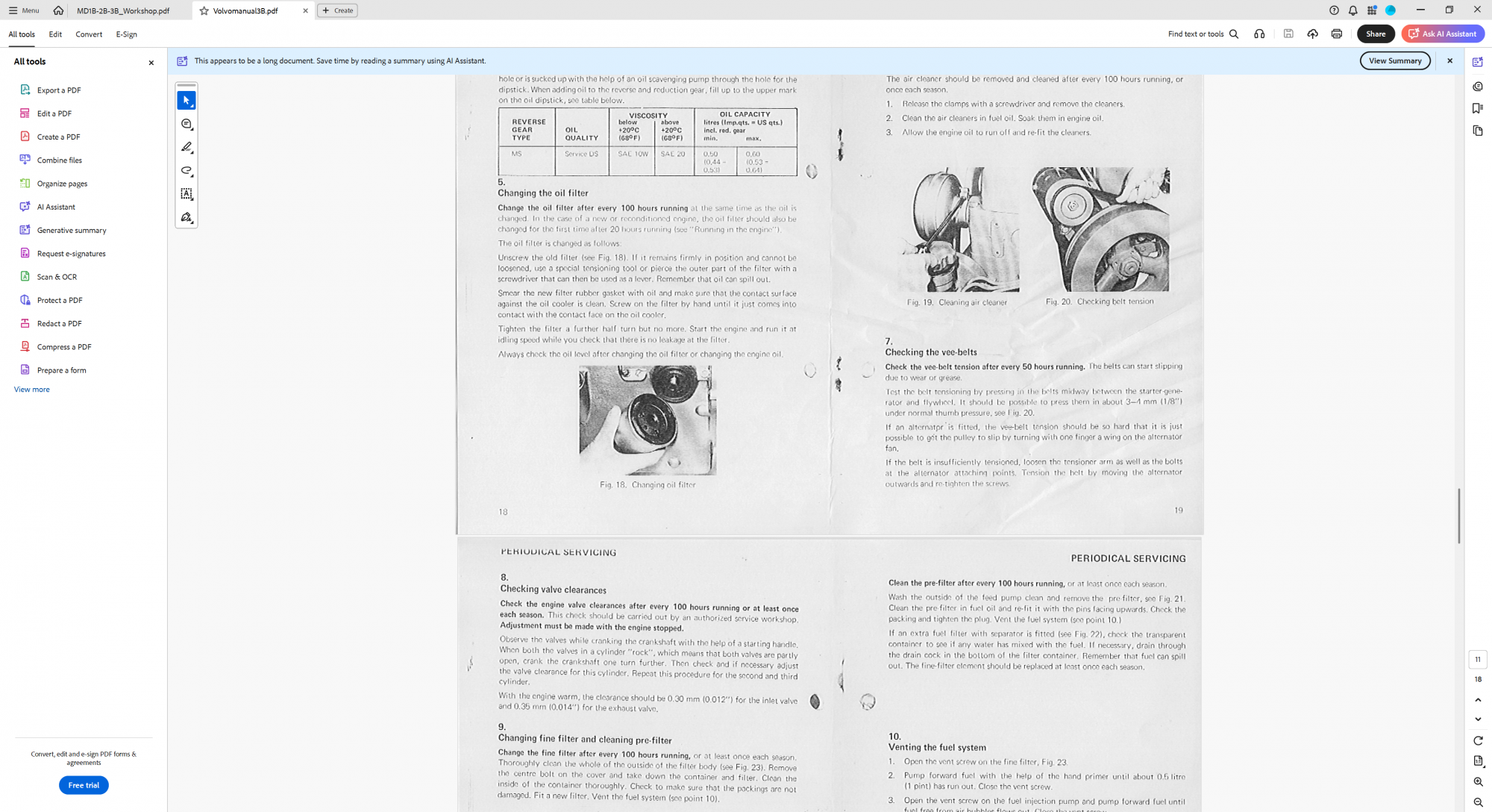

The Manual says.
It says test the belt by pressing and it should move 3-4mm under normal thumb pressure.
This is fine.
But

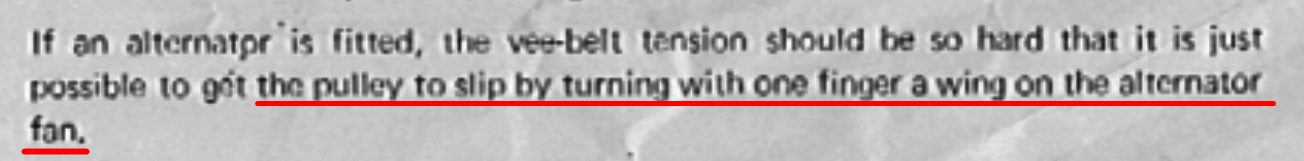

It says if an alternator is fitted ((which it is installed))) the tension should be so hard that it is just possible to get the pulley to slip by turning with one finger a wing on the alternator.

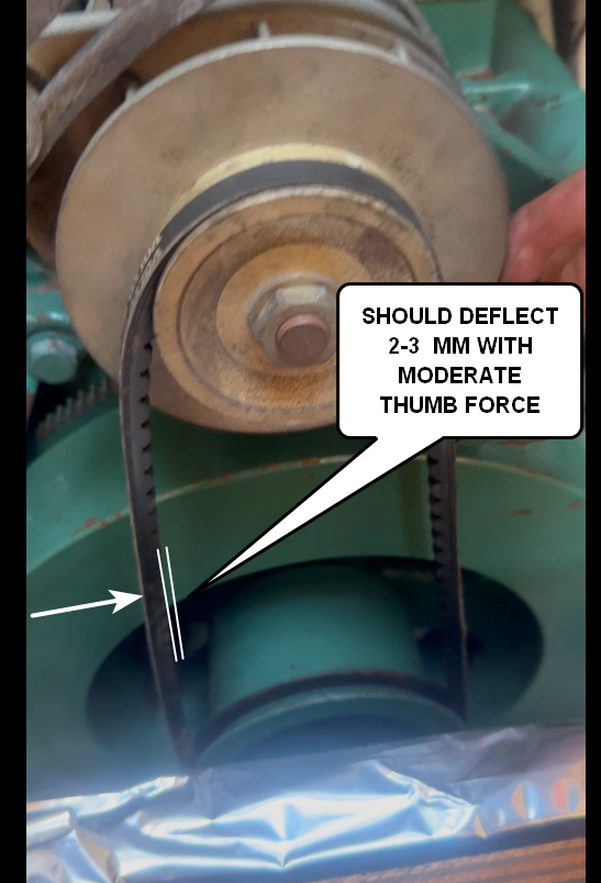

I put a video of what it looks like tensioned hard but where I can still turn it with one finger.
drive.google.com
To me it seems too loose.
Any suggestions or should i just run it see if I get dust or noise over time ?
