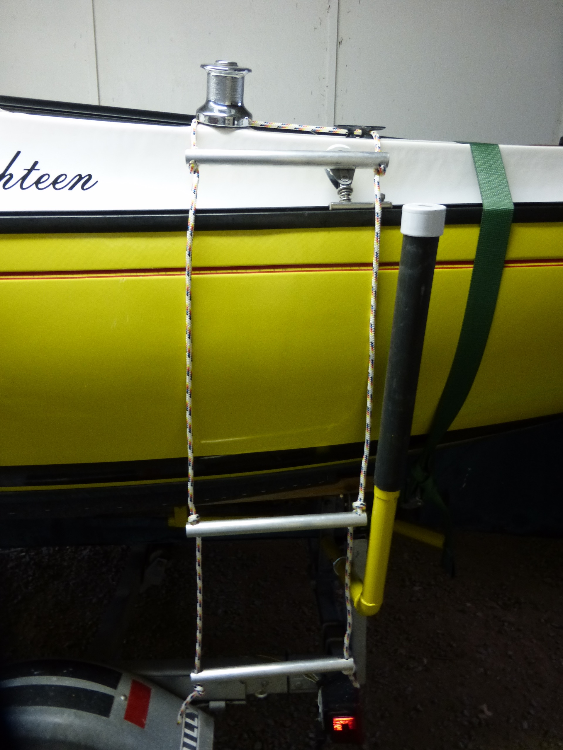

Thanks Tom, this might do it for me. It looks to be lower than my swim ladder, so I could get onto from my raft. I still think I might need a raft with a rigid bottom.
