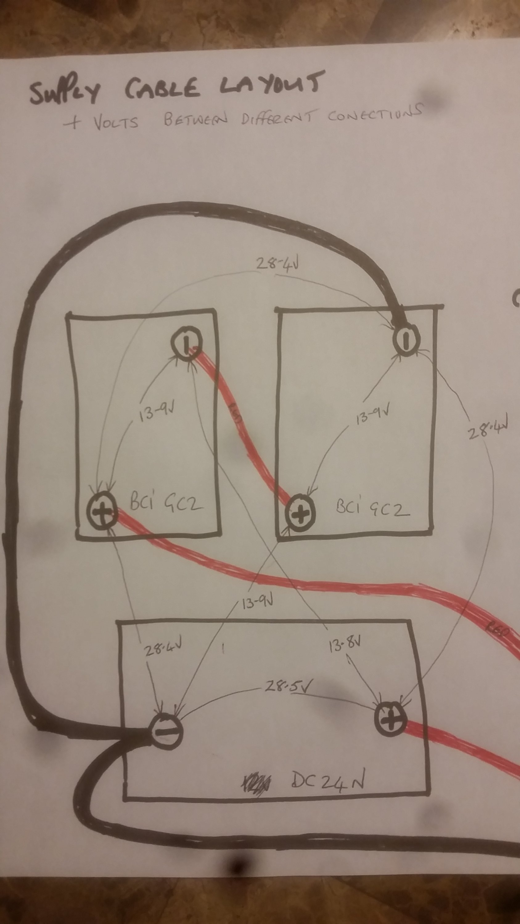

Most confusing is why the bottom battery 24dc shows 28v between its terminals, i am a contractor and build my own houses , i can frame , plumb, roof, drywall, tile and everything on them but electrics drives me crazy!!

The battery switch may be wired wrong, but I don't think that is the case. Again, I would recommend removing the ground wire from the batteries so they are no longer connected to anything. Then just read the three batteries from + to - but only on each battery, not between batteries. That will tell us exactly what the voltage is on each battery.

I'm confused too as to what's causing the 28V readings. I agree with Brian that you really need to separate all of the batteries by disconnecting the grounds and measure them each individually.

28volts (14+14 where your 12v batteries are fully charged) is easy to get if you have 2 sets of batteries where the negative is tied together and positives are isolated, which is the case of about 99% of marine installs with two sets of batteries (house and start). Getting 24v within a set is more unusual.

From the drawing , looking at the voltage readings, my guess is all bats are 12v and the readings were taken with the switch in the BOTH position. If true, the 2 bat bank is wired in series and should be in parallel.
WILF, the normal way to wire is so that either bank (or both together) will supply power to everything - engine, lights, etc. Using one to start eng and the other for house requires you to switch between position 1 and 2 as appropriate.
Mainsail has the best recmendation for this arrangement - use the larger "house" bank for everything, keep the "start battery" as an emergency backup - make sure you check it and keep it charged. I believe if the combiner is properly wired it will ensure the start is kept charged.

The 2 6v GC batteries are wired in Series, that gives you the 13 v (remember batteries voltages are nominal, i.e., a 12 V battery is really about 12.5 when charged and at rest) and then the 12v battery is wired in series with the 2 6v batteries. That's how you get to 28v.
The question then, is how did the 2 banks end up in series? I think part of the problem is that the negative cables are connected together at a battery post. Break that connection and check the voltages. The other problem is going to be at the positive end. Somehow, the positive wire is connecting to the negative to make a series connection between the 2 banks.
Time to trace the other end of the circuit. It could be at the switch or the refrigerator or starter. How are the negative cables connected to the engine block? Where do the positive cables go?

Heres a diagram showing where each cable is positioned and also showing the volts between the different terminals, does this configuration of the batteries look correct ?
Some of these readings are as close to an impossibility as there is. For instance you can not read 28.5V across the positive post & negative post of a 12V battery, the DC24N, without the battery having already exploded. If you are reading 28.5V across the pos & neg terminals on the 12V battery that means the battery is at 28.5V and that is simply not going to happen without some rather explosive results and LOTS of current......
I would check your DVM then check all your wiring...

Well As i said earlier i know nothing about electrics but i have figured out one thing, i must have had the voltmeter on the wrong setting! (dumb arse ha ha) because i tested it now and the new 12v battery shows around 14v and the 2 others show 6.2v each or 12.4v combined,
This is why I said your readings were near impossible..:wink:

OK, there's lots of confusion in this thread. The first thing you have to do is disconnect ALL the batteries. The safest way to do this is remove the negative (common) leads first. Then remove the positive leads. Then and only then can you get a definitive voltage reading from each battery. As an aside...first use your voltmeter to test a couple of other batteries...say on some cars, just to be sure the meter hasn't gone wonky. Car batteries should read around 12.5 Vdc.
Do you have an owners manual for the boat? If so it should have a section on the DC circuits that could be very helpful.
As noted in other responses, the voltage readings you have really don't make any sense so I would suggest that, while you have everything disconnected, you need to check for stray voltages and poor connections.
First, check each cable connection to be sure that it is clean and tight.
To check for stray voltage, find a place to connect your meter to ground that is clean, dry and away from the common connection used by the batteries. Disconnect from shore power when doing this test! Then put the meter's positive lead on each of the positive cables and then each of the negative cables. There should be ZERO volts at every one of these connections. If you see any voltage you have further problems and it's probably time to call in a pro.
Once you have determined that there is no voltage on these connections it would be a good idea to check the resistance reading on them, It should be zero or nearly zero ohms. Also check for voltage and resistance between were the negative cables connect to ground and the point you have chosen for the negative cable on your meter.
