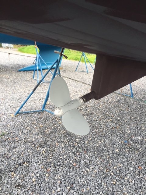

So this is my 3-blade Max-Prop. You will notice it has tight clearance between the prop body and the cutless bearing vent. So I use a special thin 'Benteau anode" (aluminum), polish the end of the MaxProp and butt the anode tight to it for extra corrosion protection. The prop also has an anode on the aft end. That is a 30mm shaft, tapered. The prop is painted with Pettit Zinc paint.
