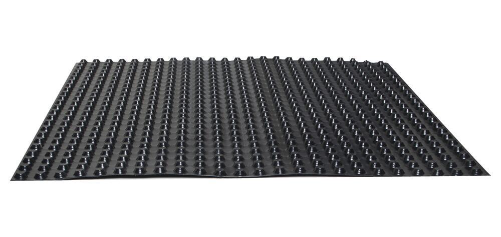

We used the Froli plastic spring system on our previous boat. Adjusted easily to fit the awkward space (e.g. in the V-berth) and was simple to install. Worked well to keep mold & any odors away and made the cushions much more comfortable to sleep on.

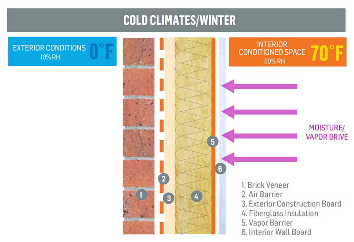

The original Hunter mattresses installed on our 1999 H-310, first had their interior foam rolled in polyethylene film and then evacuated (as I did when installing harder foam) with a vacuum cleaner. The foam rubber shrivels down to something about a 1/4" thick which easily slips inside the zippered mattress cover. The plastic slowly leaks and fills with air to its original thickness again. Supposedly, this is how foam filled mattresses are made. The thin poly acts as a vapor barrier. Think of the vapor barrier in an outside wall in a house and how it works which I'm sure, requires no explanation. But for the naysayers :

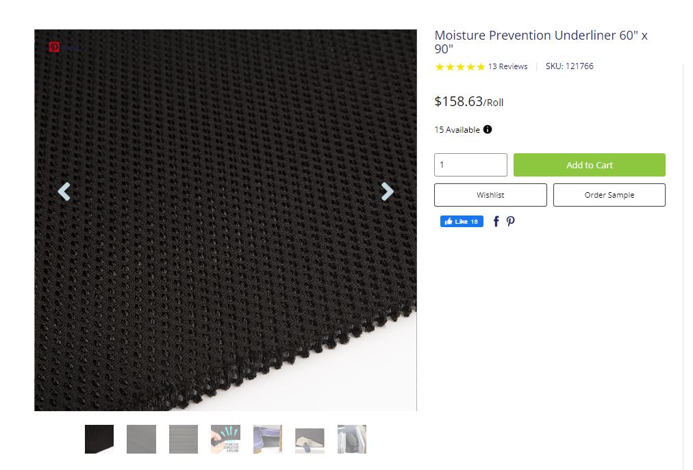

After looking at @patbratton 's underlayment from Sailrite, I wondered how the price compared to poly film as a vapour barrier :
This supplied enough material for ONE mattress.

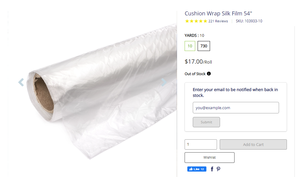

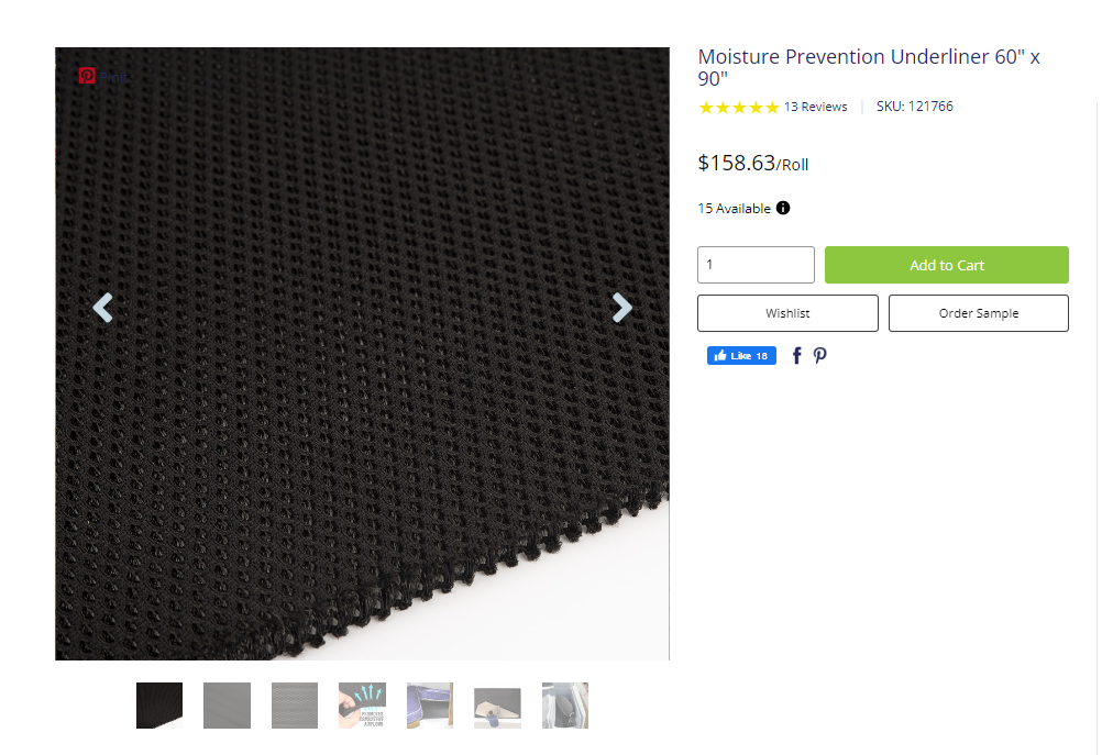

Looking at the poly vapour barrier :
I would think 10 yards would be enough for a whole boatload of mattresses. Aw, what the heck, go crazy and use one roll at $17.00 per mattress, it's still cheaper than $158.63 per mattress and far superior at that. Stop the moisture at the source rather than letting it travel through the mattress and condense on the cold bottom and then hoping it will dry out the next day.
Mind you, looking at @dlochner 's note re the Sailrite video on packing foam into cushion covers led me to their "cushion wrap silk film" which would be much easier than begging dry cleaning bags from our local dry cleaner as I did. They worked just as well but more difficult to install.
