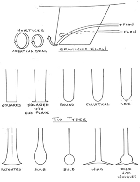

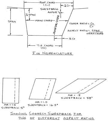

I have the shoal draft H33. Does anyone know what I would be drilling into from the tip underside? Is it fiberglass filled with lead shot or is it molded lead without a fiberglass casing? I was thinking about adding a bronze end plate (end-cap) to the tip. I've attached some gifs of the profiles and end-cap concept put forward by Ted Brewer some time ago and should improve laminar flow over the keel span and reduce drag vortices.

The bottom was recently sand-blasted and barrier coated (including bottom of keel). Its in good shape. I just need to remove the dried out ablative, rough up a little and then epoxy the end-cap to the tip of the keel, and reinforce the attachment with 3 or 4 layers of 6-8" wide glass tape along the full chord length. The end-cap will be a fiberglass board (not trying to add weight or electrolysis) that I will either make or buy. I was considering making the end-cap out of 1/4" bronze plate but then i would be adding about 100 lbs to the tip of the keel and that requires fasteners and drilling into the lead. With fiberglass, I can trim it to shape after its mounted with a grinding drum. Then prime and paint the bottom with ablative at splash time. Not too difficult (in theory ;-).

Even with your diagrams I cannot picture the end result. I think though that I am glad my keel is standard. How would that "wing" have worked when backing out of those groundings in the ICW?
