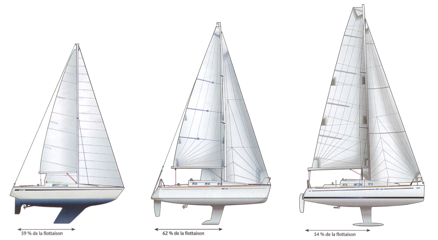

Its interesting to look at the Beneteau First 30 as it evolved, from a genoa driven masthead rig from the 70s, to a fractional but still genoa boat of the 90s to the very modern non-overlapper of today. Look at how far aft the mast is, creating a huge jib.
