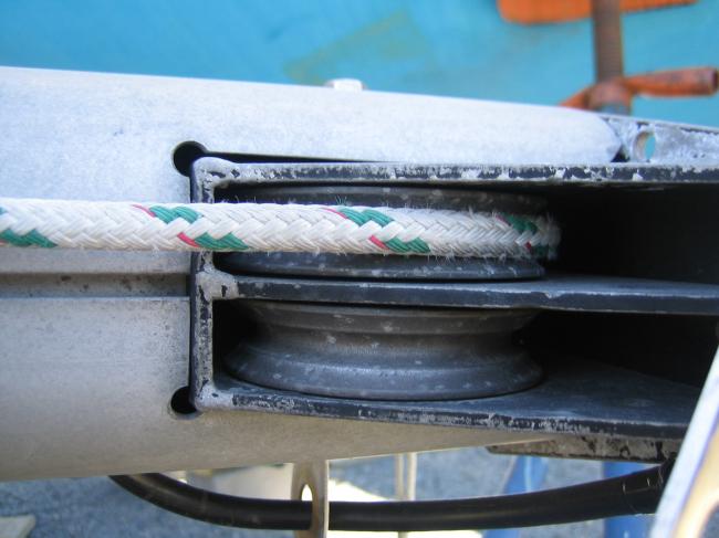

Dual sheeve ....
Made for the old fashioned rope to wire spliced halyards. Wire cable rides in the smaller groove and the rope portion rides in the wider part. Modern high tech non stretch lines/rope made the wire-rope combo obsolete.

No disagreement with Rich here
They look like they are for wire rope but wire and rope may be obsolescent but not obsolete. They are still supplied by most suppliers and I still use them. Joe S

Not obsolete... I agree
Wire/rope halyards are commonly available at most any chandlery. They are desirable where space is limited, such as the narrow masthead sheaves on Catalina 27's and the owner doesn't want to spend big bucks on high tech line. I think obsolete is the incorrect term, if you'll pardon me RichH, perhaps "uncommon on newer boats" or "less popular these days" might be a better description.

No, Rich is correct. The definition of obsolete fits. Just because you guys still love them doesn't make them not obsolete. I would have changed to all rope years ago (none of my boats ever had them), but I have never owned a boat that old. Still Jaded

They will work but...
Your halyards will wear quicker.

Mast head sheeves are easy to replace ....
Tim states correctly that with soley rope halyards, the rope will wear faster with the combo sheeves. Not a big deal if you keep an eye on the rope and trim back when necessary.

As stated, they'll work, but not the most desireable choice. If you can get that close to get that clear a photo, then changing out to new all rope sheaves shouldn't take more than a few minutes, and they aren't expensive. Go with the new sheaves.
