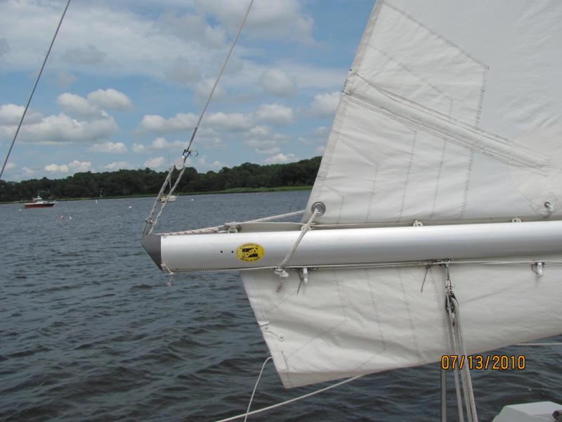

Here's what mine looks like. The first picture shows my topping lift with a bail strap that I later installed at the end of my boom. The boom never had what I'd call a good connection point for a topping lift shackle.
My topping lift is just a white neoprene covered cable very similar to a lifeline, with a marine eye swaged at the end for a single sheave.

Thanks, Joe. I noticed the backstay connects in the spot closer to the mast, and that other fitting is in the hole further to the aft of the masthead casting. Looks like I'll be switching them. A clevis pin through the casting with the 3/16" line tied to it should do fine. I'm planning to have a single block hanging on that line 18-24" above normal boom position, with a singe and becket attached to the strap on the end of the boom where the backstay pigtail usually clips on. Then I'll run a separate line from the becket to the hanging single, back down to the sheave on the end of the boom, and then forward probably at least half way up the boom. I've seen some folks with a V-jam at the end of the boom for the topping lift. But I learned on my smaller boat that if my cleat on the boom is toward the end, and I'm not dead into the wind, the end of the boom won't be over the centerline, and it can be difficult to get to the boom end. I don't care for that very much!
